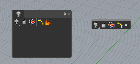

Greetings,
I can’t figure out how to make the Popup Toolbar display more than four icons.
As shown in the picture, I can only get four of them, with the rest only accessible as an extension (an arrow on the left), which is quite annoying.
I would be grateful for any suggestions or solutions that you can provide.

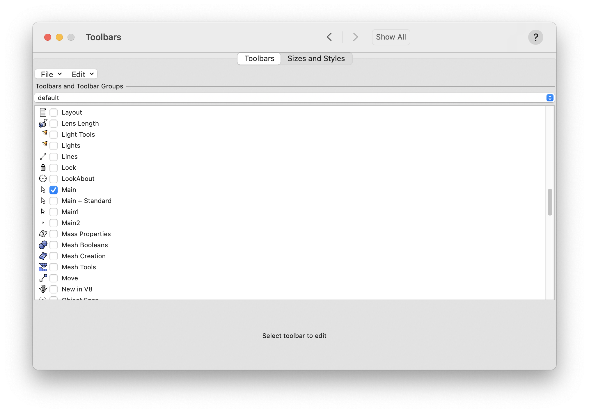

Could you try to run Reset command in the command line of Rhino and check following two options? Thanks.

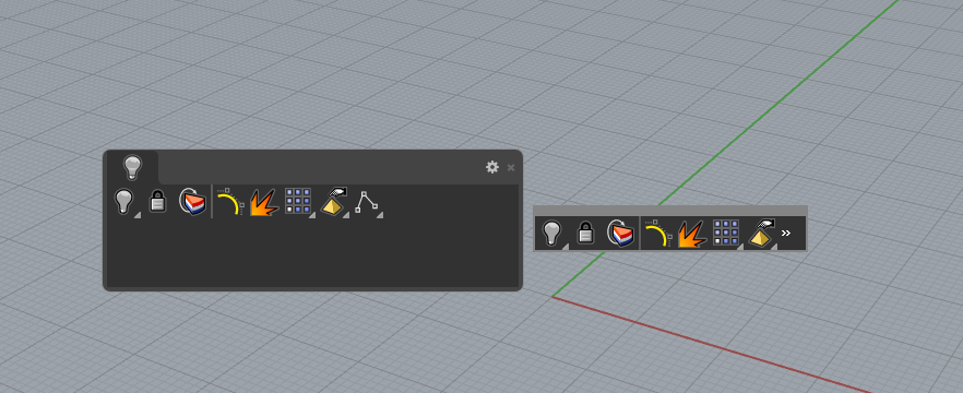

Thank you, Kyle, but… bizarrely the very last icon still remains outside the toolbar

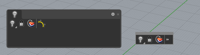

@GThib it looks like the separator is not taken into account for the size of the popup
RH-88241 Popup size is not taking separators into account

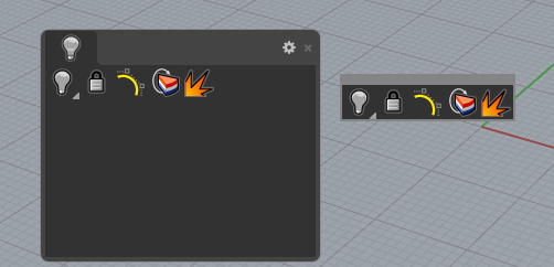

Many thanks Gijs - indeed it was a culprit.
A removed a separator and the toolbar returns to normal.

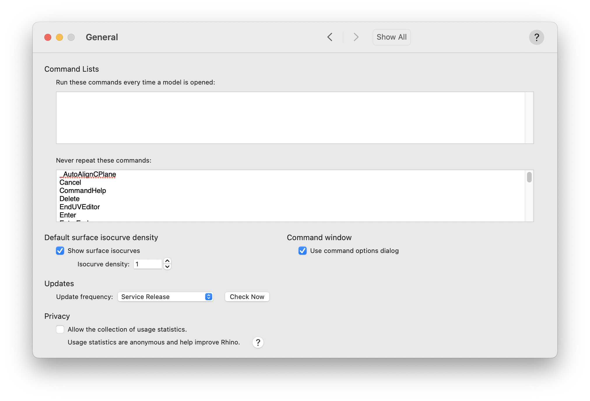

This is how you can CRASH Rhino 8 SR20 on macOS every time: 1) TurnOn UseCommandOptionsDialogue in Options. 2) Restart Rhino 8 SR20. 3) Turn the MainToolbar on again if you’ve lost it. 4) Drag’n’drop a copy of any tool from ANY toolbar to the Standard-Toolbar in the top, or any other toolbar AFAIK. // Tim
