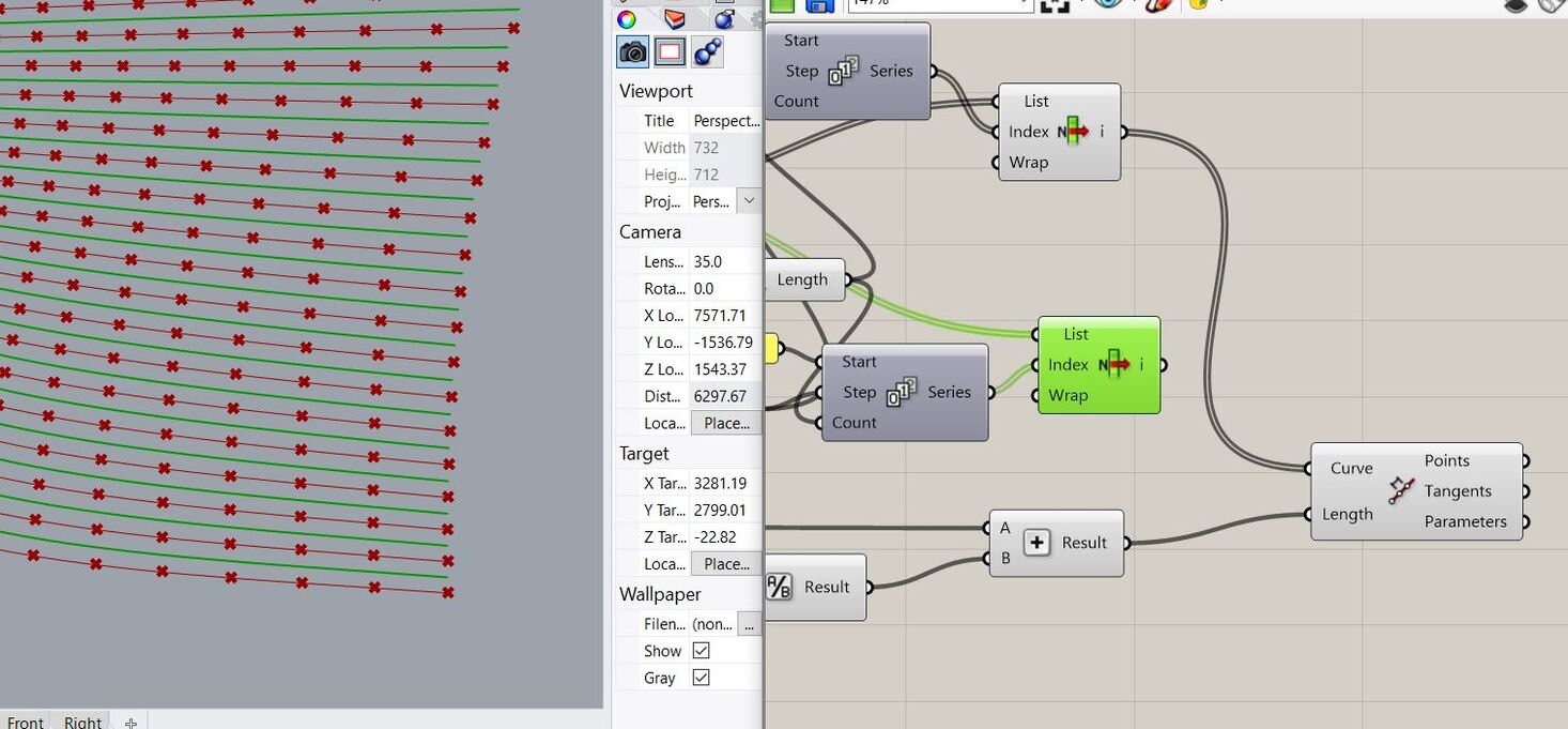

So I have this line with points on a specific distance. Now I need points on the green marked line with the same distance but they need to start 1/2 the distance further. Any suggestions? Thanks in advance.
Instead of Split Tree, the unwanted points could be culled.
Sometimes it is just that simple :sweat_smile: Thanks alot!
