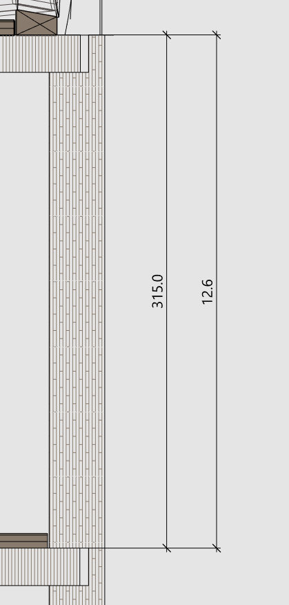

  • When dimensioning objects a layout, sometimes the scale of the Detail view, on top of which I draw the Dimension, is correctly taken, sometimes not. See screenshot.
This is crucial, of course. Must be a bug.

The trick here seems to be to create a 1:1 Layout/Detail, and only set the plan/paper scale in the print dialog > ‘View and Output Scale’.
Dimensions, Length and Distance commands work correctly then.
However, this somewhat contradicts the idea of a Layout - being a ‘paper space’, and prevents having Details with multiple scales on one page.

Still investigating Dimensions in Layout views…
Basically, Dimensions become associated to the objects they are picked from, and show their correct size when drawn on top of a Detail. This works for VA objects, too.
Nice: when Dimensions are associated with regular Rhino objects, they update themselves when the object is changed, and also after the Detail view is panned/zoomed!
Unfortunately, this is not working with blocks, and thus not with VA objects (which are blocks).
The warning “History failed to update 1 object.” is shown then.
-> one has to be careful not to pan/zoom the Detail view with Dimensions on top if it contains VA objects.

For now, as Jerry recommends, I use multiple Detail views on a Layout, with different scales, and draw on top of them in 2D if needed. To make Dimensions display the right size, the parameter ‘Length factor’ (Dimension properties > Lenth units >) can be used. However, if the Dimensions are picked from an existing object in the Detail, this isn’t necessary. Bit confusing…
Lenth and Distance commands won’t display the correct sizes. That’s a disadvantage.
