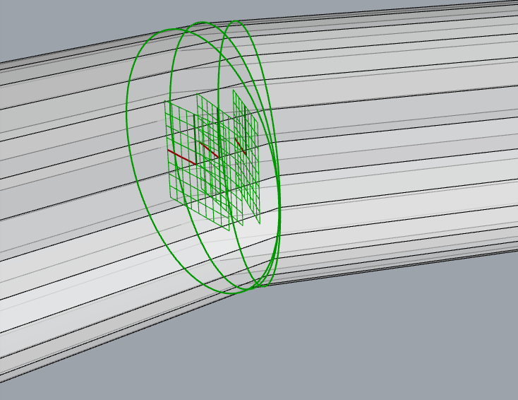

Pipe Centerline

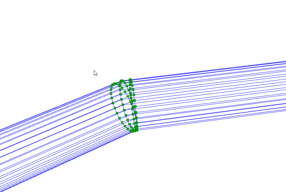

I want to group these points into three different sets, each forming different circle.
Later I want to create three different circles and get their centroids, to get centerline of a pipe geometry.
I am attaching .3dm and .gh files here, can anybody help me to achieve this.

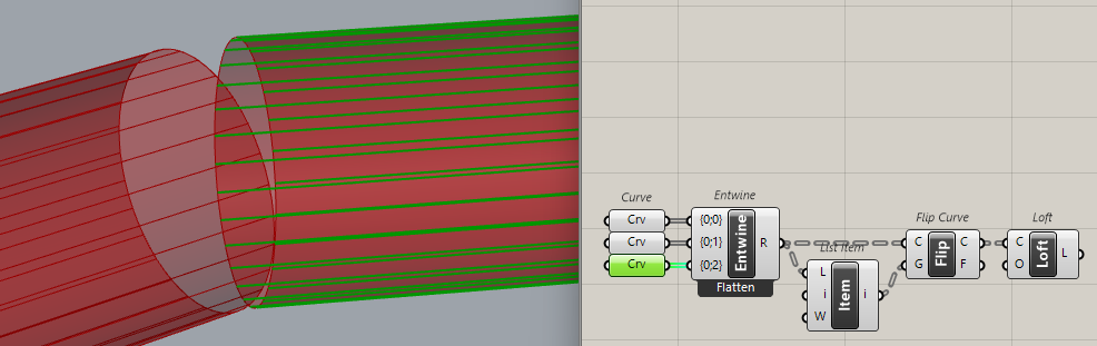

How disappointing! I could probably salvage this geometry but that’s work :bangbang:
P.S. I might start with something like this:
pipes_2025Jun17a.gh (9.7 KB)

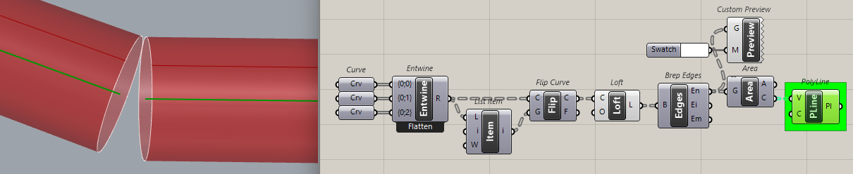

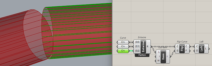

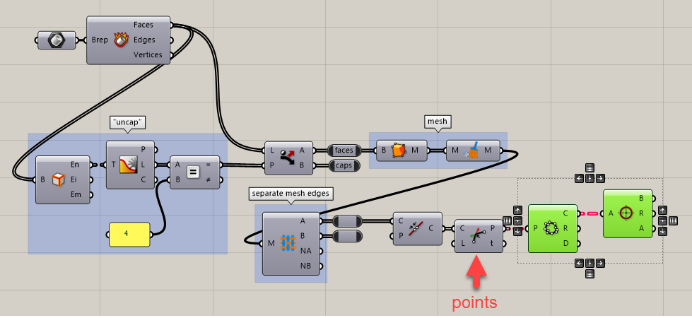

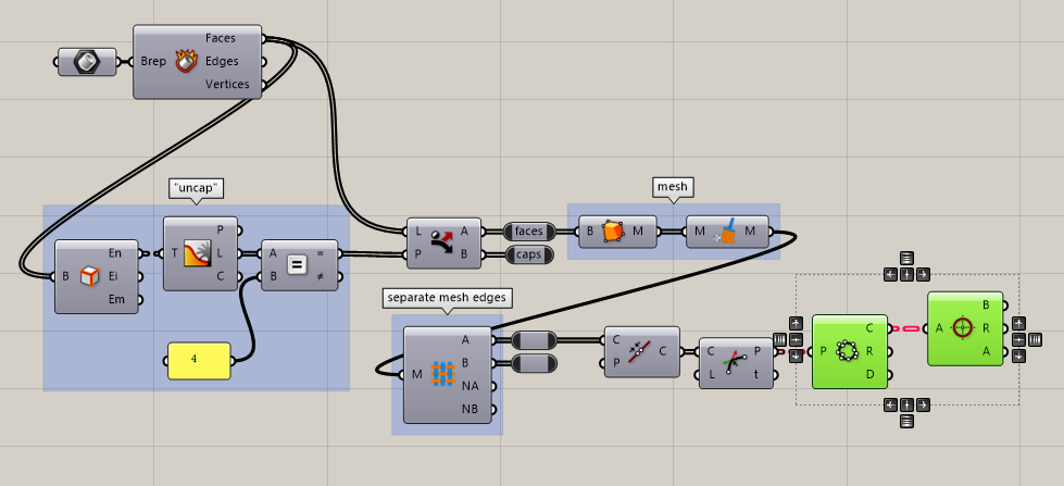

If all you care about is grabbing the centers at those rings you can try this.
(make sure your rhino tolerance is 0.001)
Test.gh (14.2 KB)

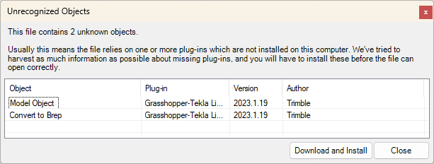

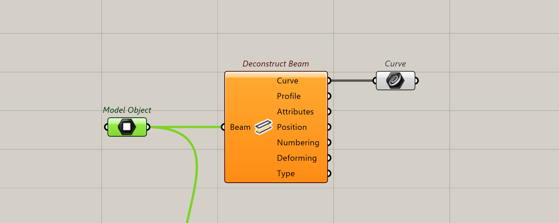

u can get pipe center curve directly in tekla live link

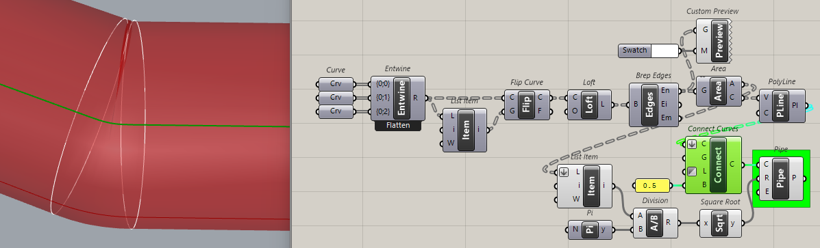

Still no solution? I prefer your first version of geometry to your second (same filenames :-1:). Many possibilities with the code I posted. Your second version has the pipe sections connected so what’s left to be done?
Two questions:
  1. Should the code be designed to connect more than three sections of pipe?
  2. Should the connections be rounded or straight intersections?
P.S. Centerlines and end edges:
pipes_2025Jun17d.gh (13.7 KB)
P.P.S.
pipes_2025Jun17e.gh (19.2 KB)
