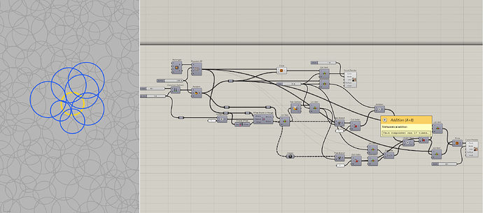

[Circle Selection By Intersecting Points Edited V0 Rtree.gh](https://discourse.mcneel.com/uploads/short-url/zYjLpAUrvXAW0fDl9WDW16WZx9h.gh) (30.3 KB)
 ![image](https://global.discourse-cdn.com/mcneel/uploads/default/original/4X/8/a/f/8aff461bb706f1f693730890aca360c2213f68b2.png)

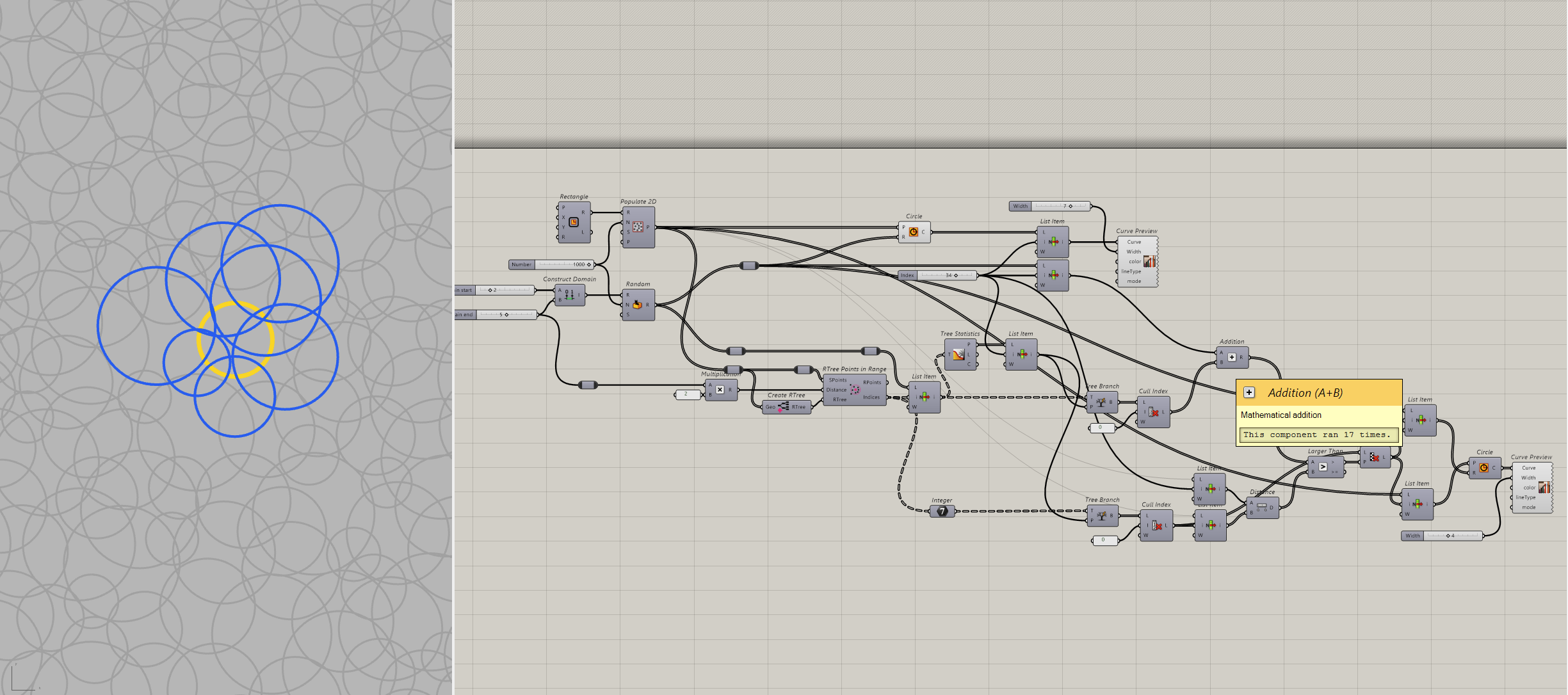

[Circle Selection By Intersecting Points Edited V1 simplified.gh](https://discourse.mcneel.com/uploads/short-url/8GR4ZIHUU1VARPZvA2WSars75p4.gh) (15.0 KB)
simplified
 ![image](https://global.discourse-cdn.com/mcneel/uploads/default/original/4X/9/f/9/9f98a600ea8af5b15d11a9594a28b330ad1e0a5b.jpeg)

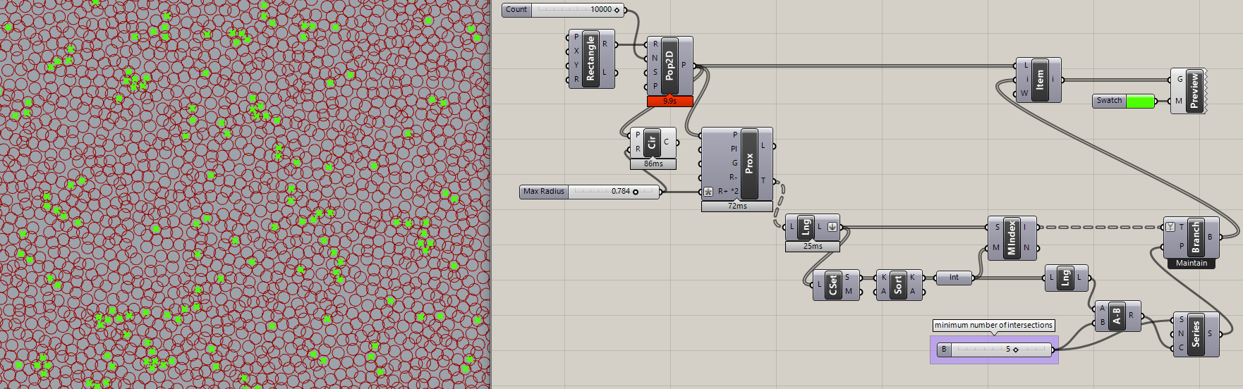

if all circles lie on the very same plane and all circles have very same radius, then you can also use Proximity2D, which might be a tad faster than RTree but would only work if both the above conditions are met
 ![image](https://global.discourse-cdn.com/mcneel/uploads/default/original/4X/3/4/1/341f3421fcd18dd78626205be4713b296fd257cd.png)
[Circle Selection By Intersecting Points\_Re.gh](https://discourse.mcneel.com/uploads/short-url/rL2XUFh135EP0GWb4XMHqspPzPC.gh) (16.2 KB)

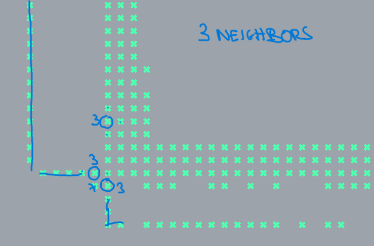

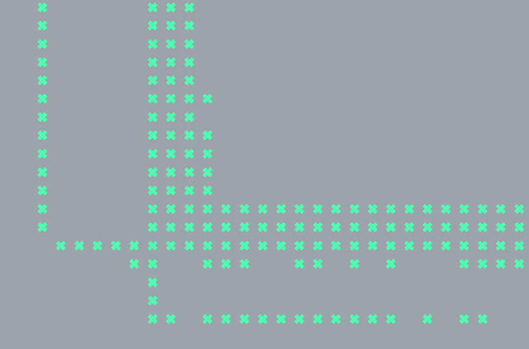

Now I’m curious, as a follow up, could this also be used to filter points (without generating circles) based on the number of neighbor points the have.
ex. given a grid with an even distribution of points where some points are missing, have the ability to select only the points that have 1, 2, 3, etc closest neighbors surrounding them. I’ve Included a screenshot as an example. (the doodle is a loose example)
Thanks for any additional feedback!

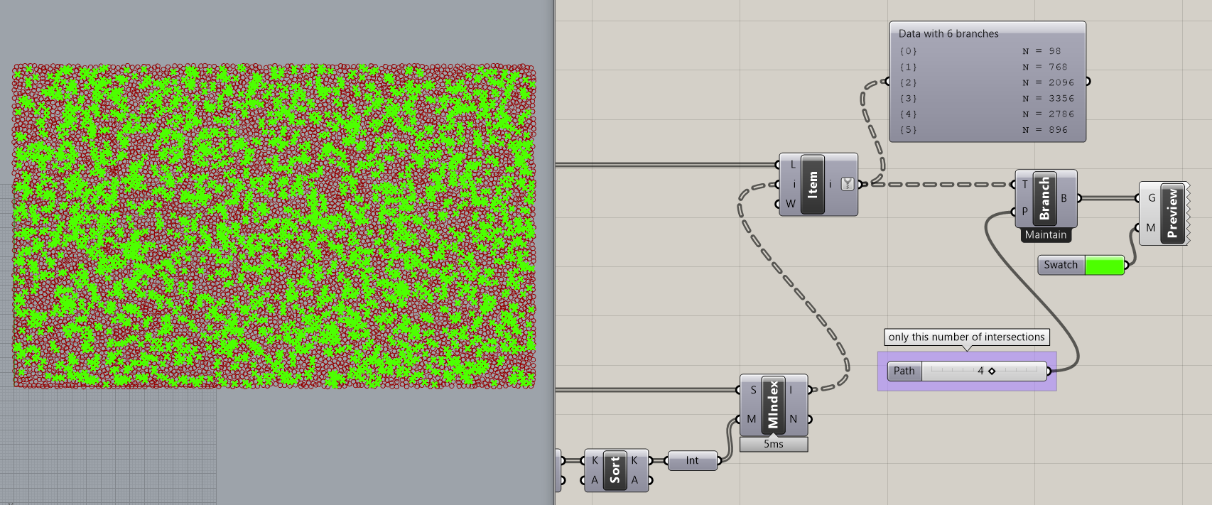

 ![image](https://global.discourse-cdn.com/mcneel/uploads/default/original/4X/f/7/d/f7d07f2e047f09d87cf7b0c083cc2552ed27e9c0.jpeg)
but if you trim it out you will chose only points with exactly that amount of intersections:
 ![image](https://global.discourse-cdn.com/mcneel/uploads/default/original/4X/d/2/6/d26bbf77dea8c019dd672b044cf388e2c31b473f.jpeg)
[Circle Selection By Intersecting Points\_Re\_Re.gh](https://discourse.mcneel.com/uploads/short-url/cbYvw3r1EaKAIn3ugg3a0EPuXbz.gh) (15.4 KB)
if you want to recreate a complete data tree with all the points divided in branches, where branch address {n} contains all the points with n neighbors:
 ![image](https://global.discourse-cdn.com/mcneel/uploads/default/original/4X/2/6/e/26e2ca150b293339ffecff7eca55e35e72433d22.png)
