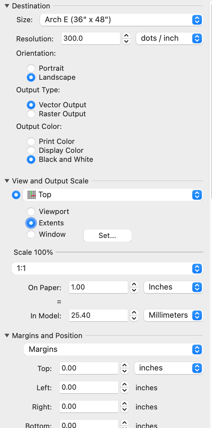

Hey guys -
I’m exporting some blueprints and while the PDF preview screen looks good, when I use ‘Preview’ on my Mac or open the PDF in Acrobat, there are some squares near all of the dimensions. Any ‘text’ I’ve added is rendering fine, but you can see around the fractional dimensions, there are the s.
Thanks in advance!
-Mike

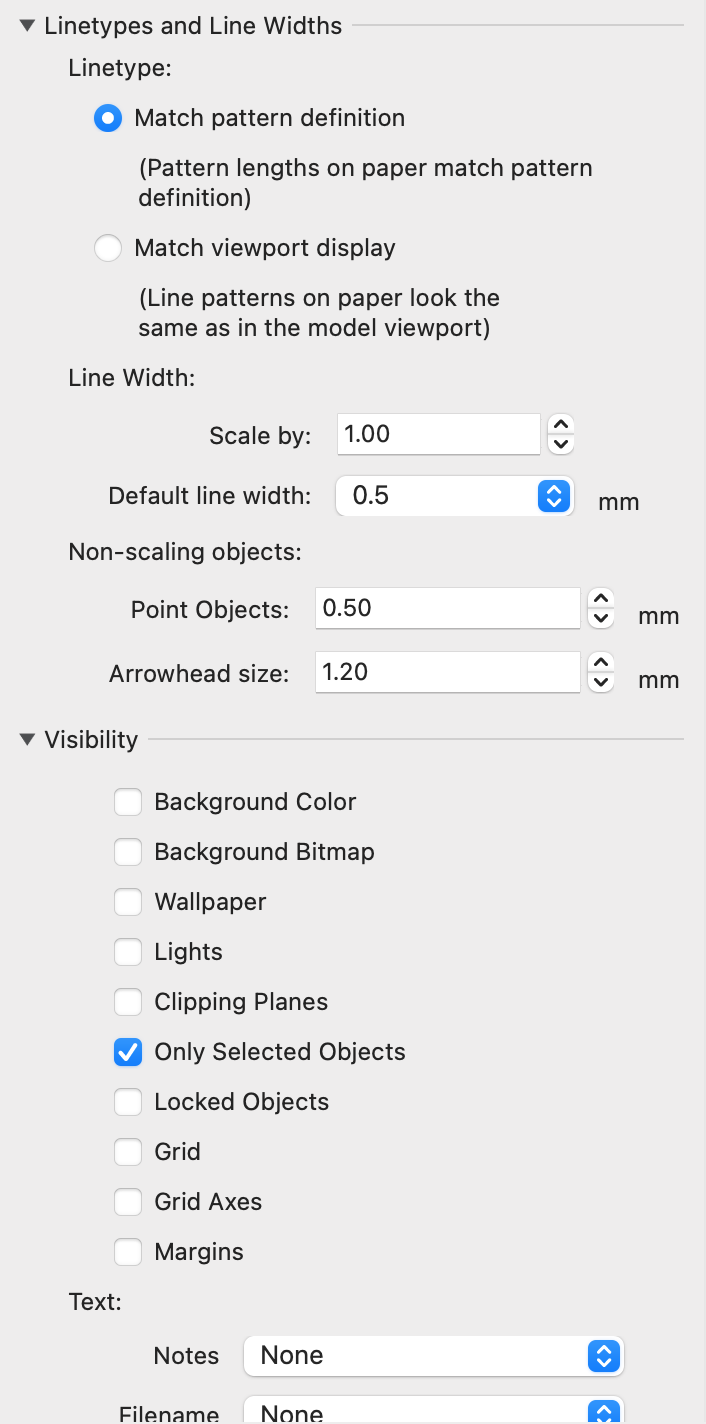

I have all 8 pages of the blueprint on in one file on the ‘Front View’ and then I’m selecting the single blueprint > Export Selected and then my parameters are as follows (2 screenshots):
My hope is that it’s not because of it being a ‘non system font’. I found a similar post on the forums that pointed to that. However, any of the ‘text’ I’ve added to the blueprints renders fine. It’s only in the dimensions that those boxes show up.
Cheers!
Mike

Far from a real solution (and maybe only a 20% change of working) but the font will sometimes appear correctly with “raster” output if it isn’t with vector output.
Hey Keith -
That definitely worked. Thank you.
