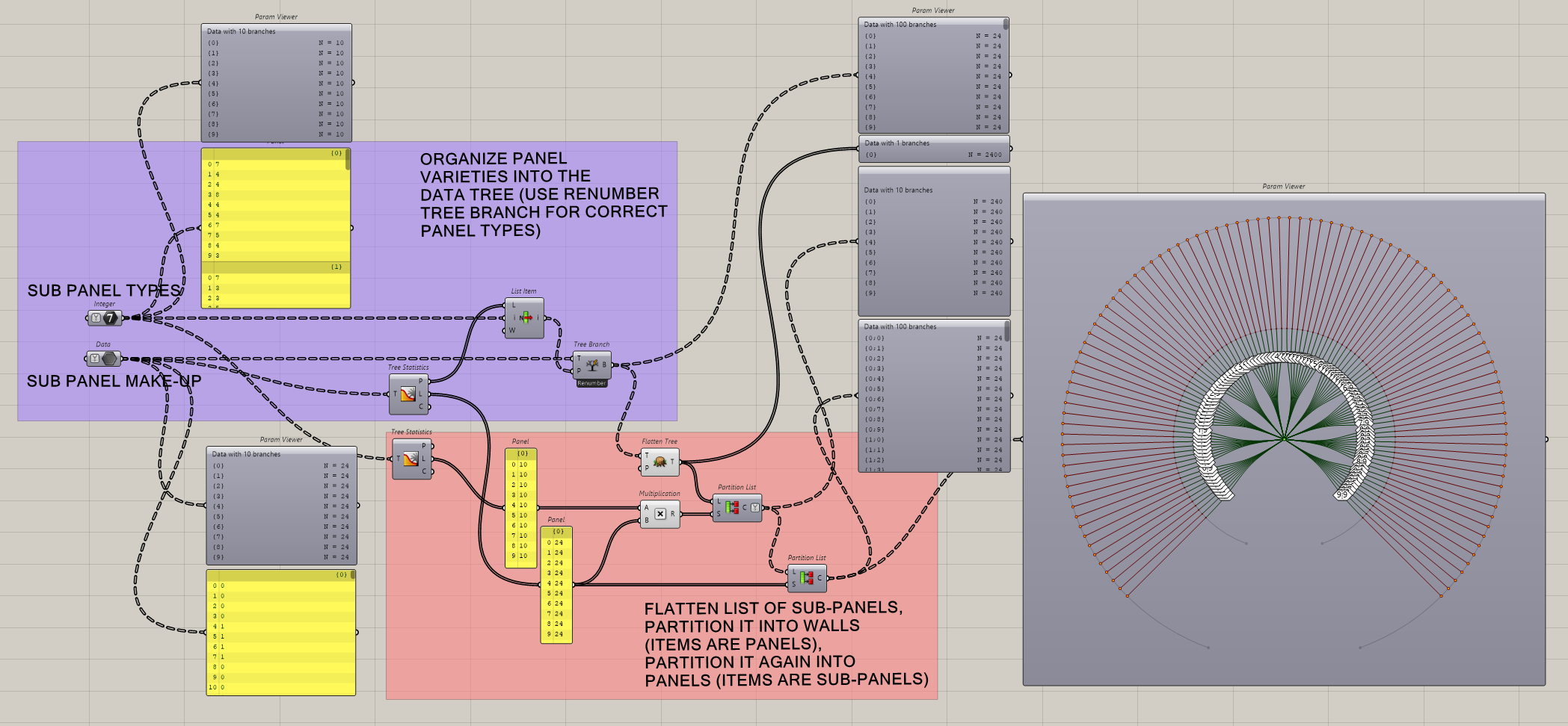

I am trying to take a data tree and and move every N branches into a new branch. So for example if the tree has 100 branches, I’d like to put every 10 of them into a new branch - resulting in 10 branches of 10 branches. It’s working for lists, but I can’t get it to work for trees.
This is all dynamic so the path mapper won’t work. The background is that I have a component for putting wall panels together. Each panel is a group of sub-panels, each sub panel is a pattern of 1’s and 0’s.
To keep it fast, this is all just numbers, the numbers drive the other part of the component which is geometry.

Here is the script I used from @magicteddy as applied to the problem:
Also, here is a rebuild of the tree that I ended up doing earlier in the day. Flattening and re-building the tree into a new structure was a little more intuitive than replacing actual paths:
The saved script is attached.
partition tree problem.gh (27.2 KB)
Works with data structures with single items in input branches.
