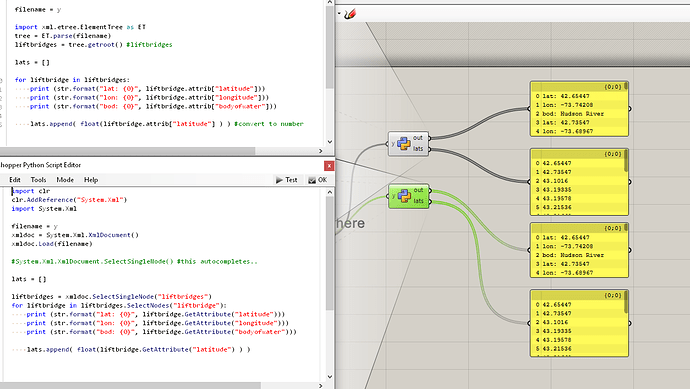

Ya: I can parse with the ET, but not with Steve’s Code. Probably some way to do it. Files to test:
 ![Parsing_GH_R0](https://global.discourse-cdn.com/mcneel/uploads/default/original/3X/a/6/a6e6e3ccec1bdf617b9879d7aec826c58e04d7ca.jpeg) [liftbridges.xml](https://discourse.mcneel.com/uploads/short-url/gR0br8UaBcm1RXNeL4SAUTIQjr1.xml) (4.3 KB) [Parse\_GH\_WIP\_R0.gh](https://discourse.mcneel.com/uploads/short-url/jhULcMXfyAknYxifkfzr9loEULo.gh) (8.2 KB)

This works fine with both libraries in Rhino 6. Each can be used, and one is more “.Net”-y, and the other is more “classic Python”. Other than this, I don’t see any problem with any of them, and they give the same results.
 ![image](https://global.discourse-cdn.com/mcneel/uploads/default/original/3X/a/2/a2d2be10363e4f2cdf09233f49e8a2fb92b410e6.png)
In Rhino 5, only the second one will work, because the old version of IronPython did not include the `expat` module.
I’ve attached a fuller example for both of these, applied to your XML.
[for\_robe5177.gh](https://discourse.mcneel.com/uploads/short-url/j9x80TsddB2V5EXEQF19ejncKoP.gh) (9.7 KB)
