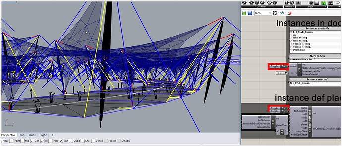

I am a student working on the deployable structure. I would like to use the same joining technique (arc triangular section arches) to create a pavilion of different shapes in the shape of a triangle or square if it forms a dome. I am a beginner in rhino (grasshopper), I can not do the design of this structure.Is what someone could help me dear member

BUT … the fabric concept is wrong since it yields a shading shape that (a) covers a very small percentage of the footprint (so what’s the purpose of doing it?) PLUS (b) is “linear” in U (or V). In order to achieve a real-life tensile membrane like this one you should use the one point up the next down rule otherwise you would apply colossal forces to stabilize the membrane with absolutely no reason. This would affect the sizes of the LBS members/nodes/anchor plates etc etc. Solving (“relaxing”) a similar properly anchored up-down membrane is done via (a) a well defined mesh (b) a Physics Engine (i.e. Kangaroo2 [ the best GH add-on by 1M miles] available for GH by a certain Daniel P). Get the thing and try to get familiar with what it does - there’s some simple tensile mebrane examples available as well in the demos included.
BTW: In membranes and K2 ALWAYS separate the clothed edges from the naked ones and apply different spring values - as we do in real-life membrane designs. Google: tensile membrane anchor plates images … and study various contemporary proper anchoring plate designs > see the 2 mysterious cables going “along” the perimeter from plate to plate ?.
BTW: Not 100% the same with your goal … but since it’s a kind of “linear” solution is more or less 100% the same with regard the up-down anchoring policy:

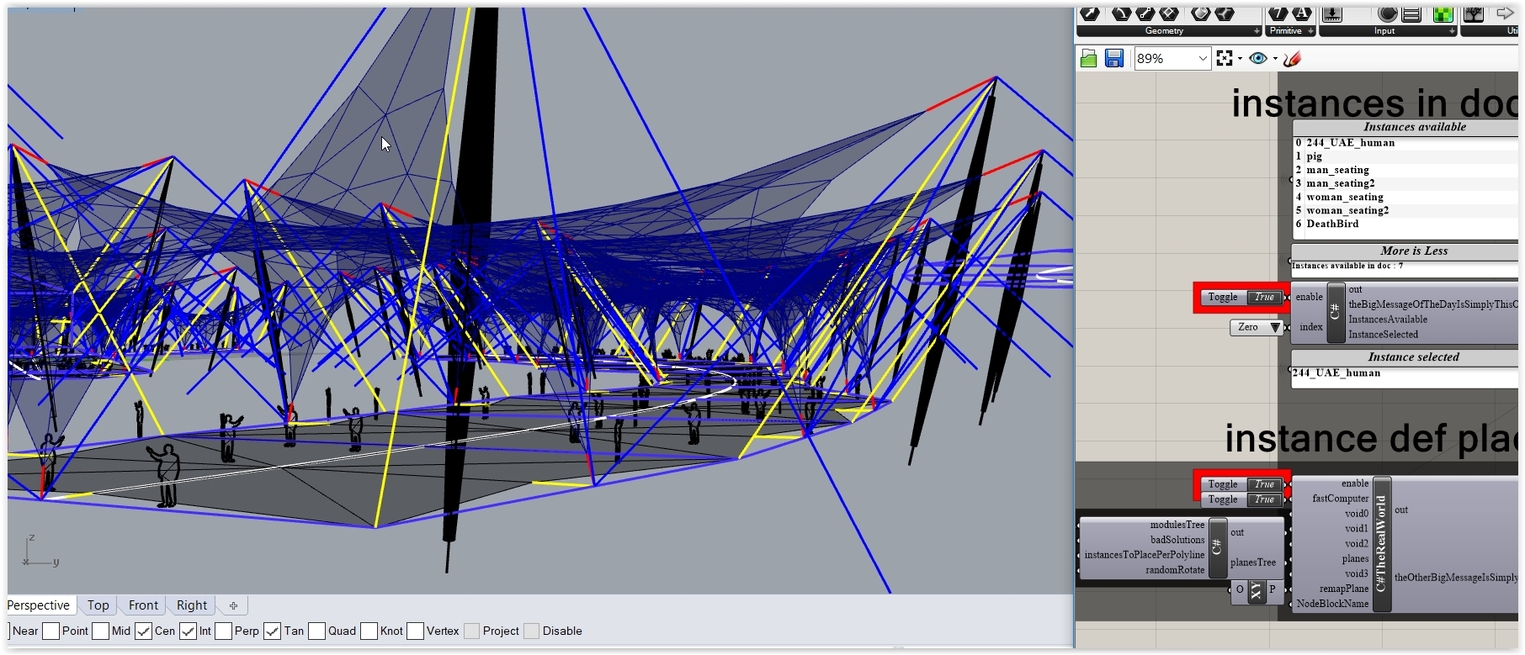

Before Kangaroo2 (mesh is flat to the ground, all cables [and other things] waiting for the salvation):
After Daniel:

here is the idea that I have in mind to do on a grasshopper
I made the prototype, I could send you by mail, if you wanted.
I also made the 1/10 scale model of a single-arc triangular section
it just misses the gransshoper coding

OK, I’ll make a rect tube option … but by inspecting the PDF … well … do a small test:
Go to some windy beach, find a friend who does windsurfing and ask him to hold the sail in an upright position (fully closed in). Now the sail could be anything between 4 to 9 m2 … so just imagine 10++ (or 100++) times that size and start realizing the forces involved with membranes (plus the ones required for achieving the shape). That said the mast is a 50-100% carbon very expensive tube that can handle BIG forces: what chances have your wood sticks? (not to mention your nodes/joins)
All that having membranes in mind and not some sort of fabric that … well … if is this the case why bother doing it? It would be a very short lived thingy (gone with the wind etc etc).

Finally indeed: here’s a thing that closely emulates the real-thing logic. The rigid sections truss concept is the same as in V1 (with regard the rigid members (whites)) but … let’s say that this C# is canibalized from the - internal - original def … er … with a far more legant way. Note: since a spine is used (that can have any shape) the extensive topological checks for the solution validity are removed (they are strictly internal, so use a “good” spine for the truss deployment).
That said the X members would be (later on) “like” the real ones that have nothing to do with tubes (nor with your wooden sticks, truth to be said).
V2A is only the layout (does 1% of the job).
Later on (if we are remotely on the same trajectories) V2B would do the real X sliding members (you would be surprised a bit) using items (either 2D or 3D) that are made/defined ONCE and then placed (as instance definitions, meaning real-time responce no matter the complexity) many times using Plane to Plane transformations (kinda what the Orient does) and V2C would do the ideal mesh plus the var/steady cables for the K2 relaxed membrane task.
