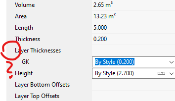

Hello!
Shouldn’t there be that little triangle? Easy to overlook that the ‘Layer Thicknesses’ param can be unfolded.
Thanks!

Hi @Eugen,
Which VA and Rhino versions are you using? I tried with the last one and everything looks fine…
The latest: 2.11.2.
It might be because I use a dark UI theme, with the ColorScheme plugin.
I’ll try that, sorry but could you tell where can I get that plugin?

Hi @Eugen,
I could reproduce the error using the dark UI theme so I have just added this issue to our list.
