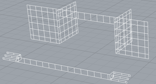

Hi @rajaa, I tried it and it works well however it’s a little different to what I was saying. Still, this would be quite handy in dividing surfaces. What I was going for was - if the dividing number was bigger than any length of the actual surface then it should only create the border points or lines. The best way I could put it is to imagine a 1x1 hole you need to close, so if you have a 2x2 surface to close it, then naturally you would cut the 2x2 surface with the borders of the 1x1 hole, so the points should only be at the borders if the divisor is bigger than the actual surface. This way it’s closer to realistic fabrication rules. I’ve uploaded a script showing the difference. Thank you.
1. Dvide Surface By Length jjj.gh (116.8 KB)
Can you please internalize your input surface.
Also please share a screenshot showing the difference? There are many plugins involved, and it helps to see an image of the results you are comparing. Thanks
