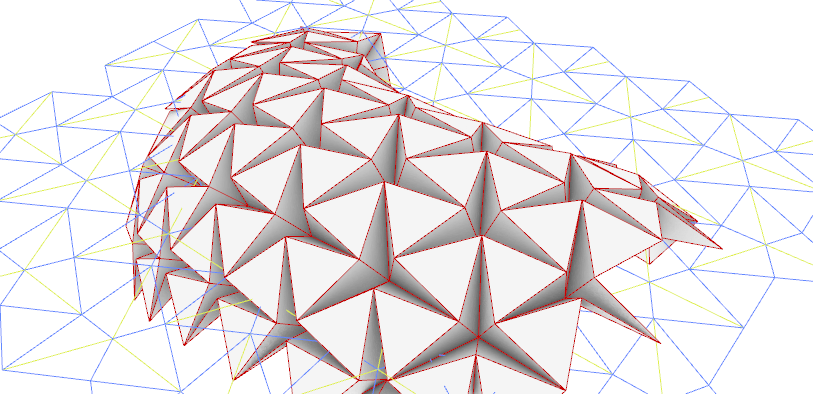

**Author:** ![DanielPiker](https://sea3.discourse-cdn.com/mcneel/user_avatar/discourse.mcneel.com/danielpiker/32/666337_2.png) [@DanielPiker](https://discourse.mcneel.com/u/DanielPiker)\
**Post date:** [January 15, 2019, 12:14pm UTC](https://discourse.mcneel.com/t/origami-model/77301/5 "2019-01-15T12:14:46Z")
</div>
![image](https://global.discourse-cdn.com/mcneel/original/3X/0/2/02f482fff1c1e862eb5074dc376be8787a8e04f3.png)
[Origami\_example.gh](https://global.discourse-cdn.com/mcneel/uploads/default/original/3X/5/3/532ff8352bf02477fb179aadd309372c280ac097.gh) (45.4 KB)

WOW！That’s amazing!
