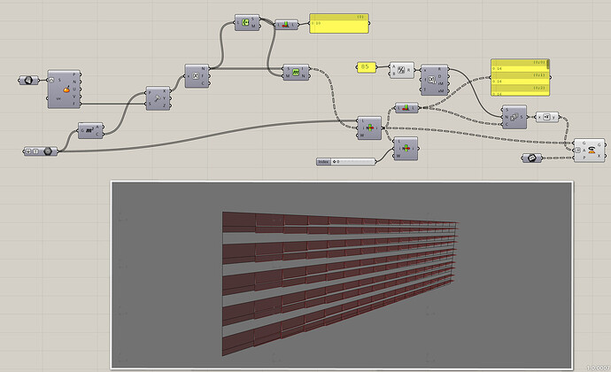

Hi all, can you please help me organize the data tree of extrusions in the attached GH file so that the rotation happens per the second screenshot? The way the rotation was done before had all the panels equal in depth but I had to list items and cul the tree so I could make some specific panels different in depth. Now when I try to put the tree back together the same procedure for rotation doesn’t work. And I tried several ways to organize the data tree to match what it used to be but am not getting anywhere. Thanks for your help! progressive rotation.gh (37.5 KB)

Clean-up on aisle five. You can reverse the Rotate ‘A’ (Angle) input if you want the rotation to be greater at the other end.
progressive rotation_2021May1a.gh (43.3 KB)

This model is almost completely useless to me. I can see that you start with two overlapping surfaces, far from the origin, each 40 X ~174 units. From the top view, they are angled ~35 degrees from the X axis, It gets vague after that, splitting both panels, selecting rows, extruding edges, etc.
A substantial portion of the threads and issues on this forum are of a similar nature. Elaborate construction of geometry without consideration for the ultimate goal, which in this case is “progressive rotation” of progressively sized panels. So some variation of what I posted yesterday is the only way forward when you start like that.
If I started from scratch, based on this portion of your image, I would do it very differently by creating rows and columns of planar rectangular surfaces. The gaps suggest the idea of making two adjacent rows that are moved/copied an arbitrary distance vertically.

After coffee… Here’s a parametric approach. It’s up to you to position and optionally rotate the initial XZ plane (purple group, top left). Or move the whole works after the fact.
progressive rotation_2021May2a.gh (26.0 KB)
Thanks a lot! I see what you did and it’s very clean. However I need the panels in the first four columns to be different in size than the rest. So if the typical panels (12 right columns) are “x” in size, the panels on the left are as such: for the red panels on the left they progressively get smaller from right to left, and the black panels progressively get larger from right to left. Looking at just the top set of panes, is there a way to make a series of 16 values that looks like this: 3.5, 3.25, 3, 2.75, 2.5, 2.5, 2.5, 2.5, 2.5, 2.5, 2.5, 2.5, 2.5, 2.5, 2.5, 2.5 for the top row of panels and another series that looks like this for the bottom row of panels: 1.5, 1.75, 2, 2.25, 2.5, 2.5, 2.5, 2.5, 2.5, 2.5, 2.5, 2.5, 2.5, 2.5, 2.5, 2.5 and assign these numbers for the “x” for the Plane Surface?
