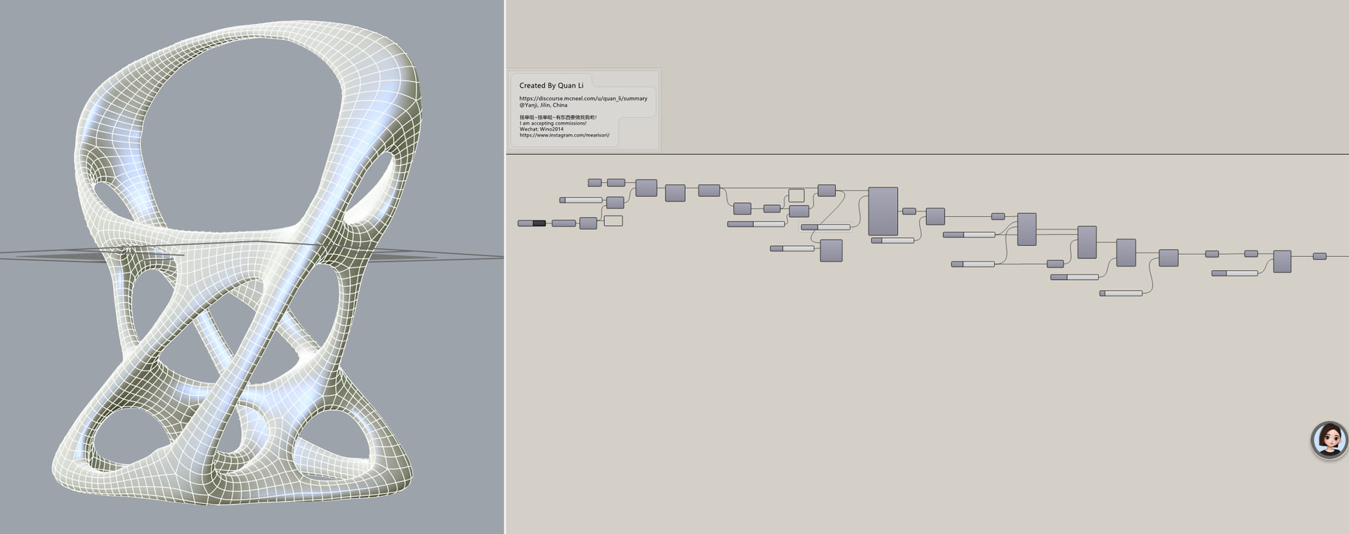

I’m attempting to create a parametric shell facade that occurs somewhat randomly and organically and through several iterations and attempts, just can not get it to flow naturally it always is too thin, too thick or too rigid and think in attempting to not do those have maybe convoluted the process
(using kangaroo 2, weaverbird(attempts))
archstruct2.gh (2.1 MB)
attached is a reference photo just off pinterest of my rough aim for the facade and my grasshopper file
thanks

In order to have a unique mesh, most of the time better. First use “Brep Join” but has you have a very big shape (60 000) unit I had to augment Rhino tolerance to 10 ! Then you can remesh …
You began quite well, but you MUST provide a list of curve to MultiPipe in order to have just one geometry. Also if you have some curves that are not connected and have proximity points Multipipe will not glue them.
So for this kind of look, tools like Dendro, IsoPod are good options. Search on this forum with Google …
Also if you want more organic look straight curves are not the best some curvature could help.
Play with parameters of Dendro
Radius, Width, Itteration, …

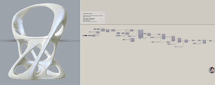

Dendro-QuadRemesh-SubD-BREP - Gallery - McNeel Forum
Beauty of not organic Multipipe - Gallery / Grasshopper - McNeel Forum
Beauty of not organic Multipipe v5.gh (62.6 KB)
