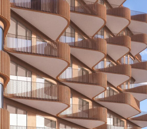

I’m working on designing balconies and want the planter to rise from the balcony floor instead of maintaining a constant height. My original design was easily created using a Sweep 1, but my current vision is more complex and challenging to model. I need help creating a smooth, flowing transition with fillets from the balcony floor to the planter. I’ve included a sketch to illustrate my idea. Can anyone assist with this?

To clarify, so you can create an effect where the balconies is also going up and down. (as seen in the reference)
Those balconies are only going out and in.
