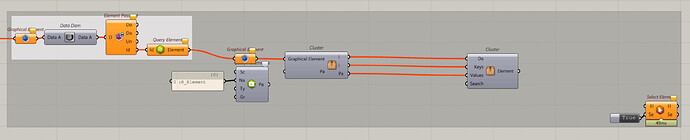

BEWARE !
I almost lost a long script at a very inconvenient moment.
I was copying a GH file from my work computer (where I use Revit) to my home computer (without Revit) to tidy something up. I thought placeholders were completely safe. They are not…
It can mess up things in clusters too. Practically impossible to rewire things back.

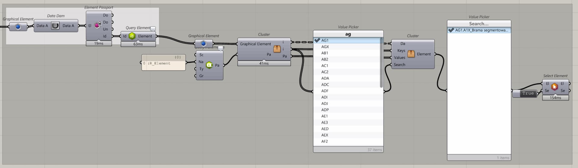

missing connections
working
broken (clusters inside are also broken!)

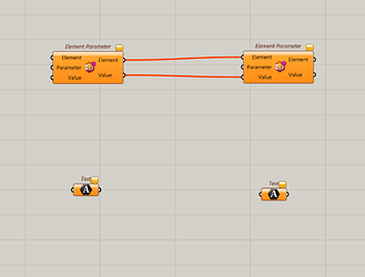

Simplified example
It doesn’t look as scary here, because it’s so obvious.

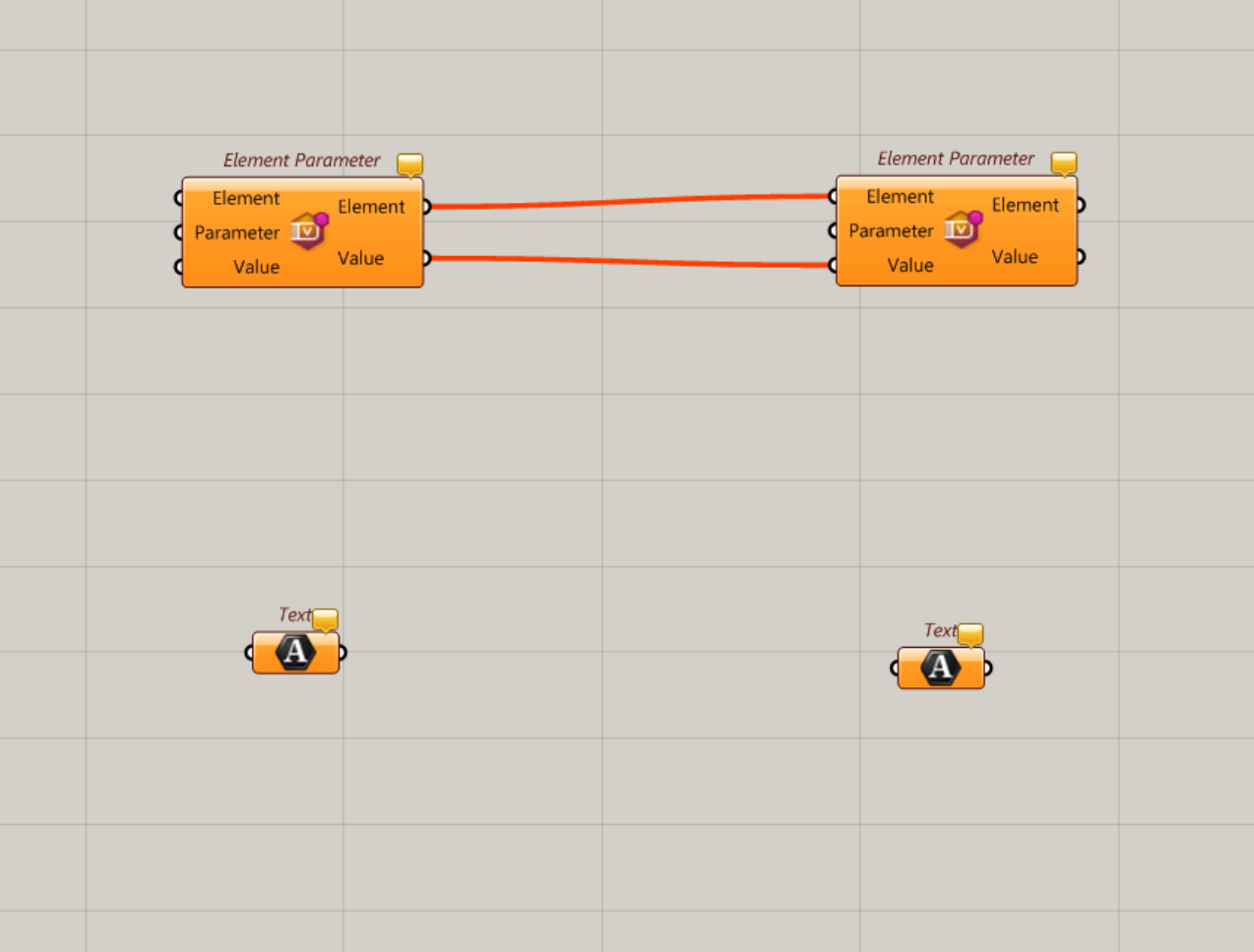

original file

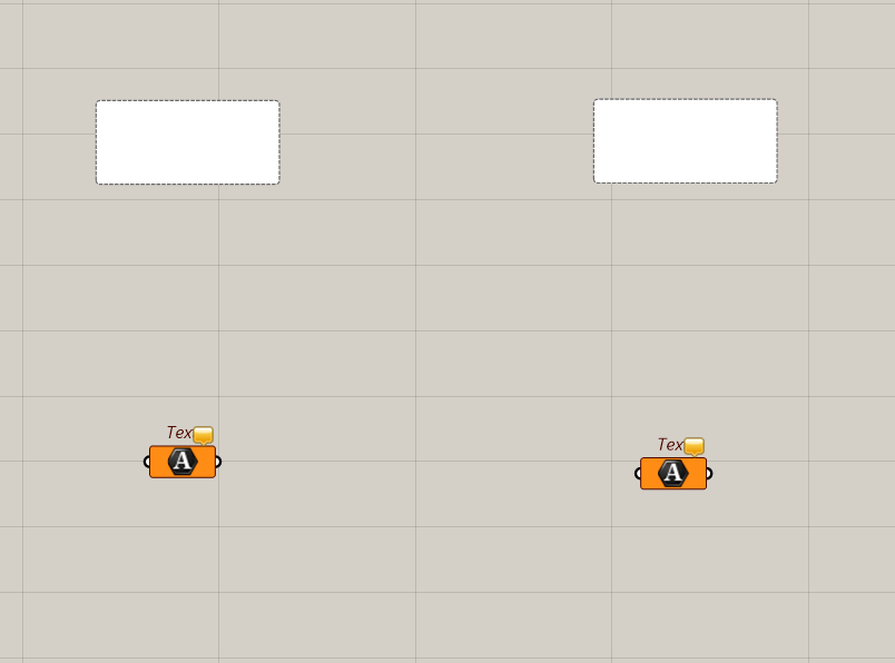

opened on a computer without Revit and saved

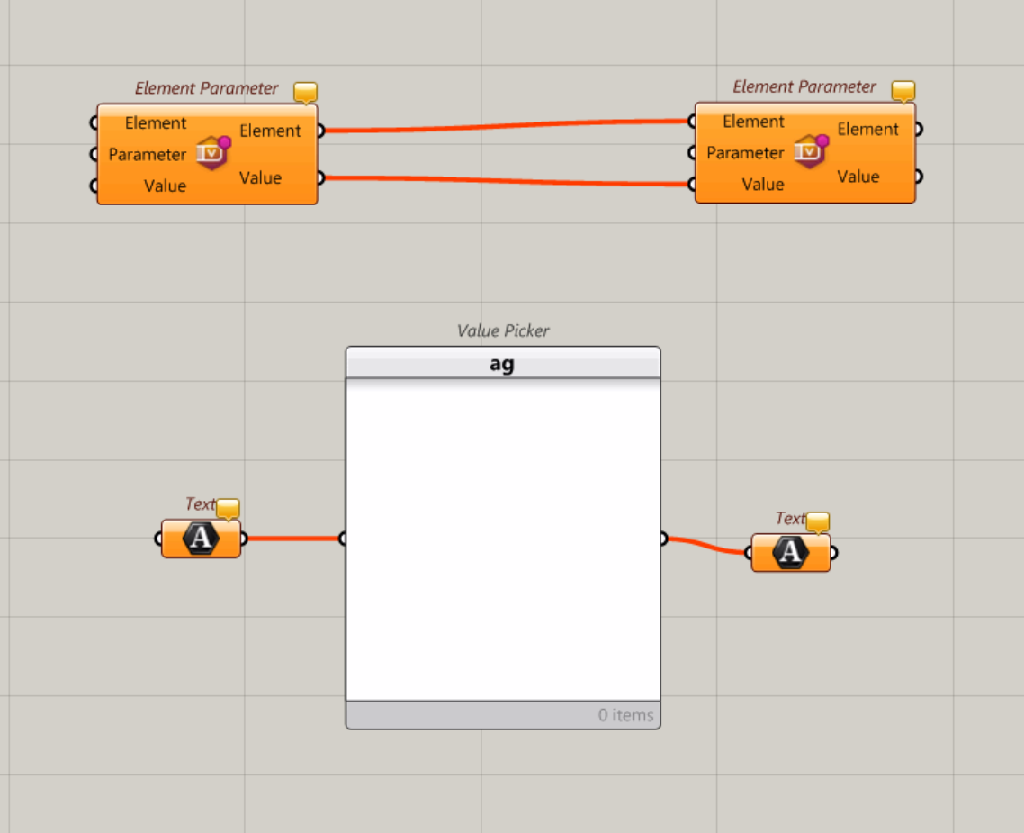

reopened on the computer with Revit
In big GH definitions that you normally open with a locked solver, you might not notice anything strange just by looking, because missing wires are not so obvious. But in fact, there might be dozens of removed wires. The nastiest thing that has happened to me using Grasshopper yet…
