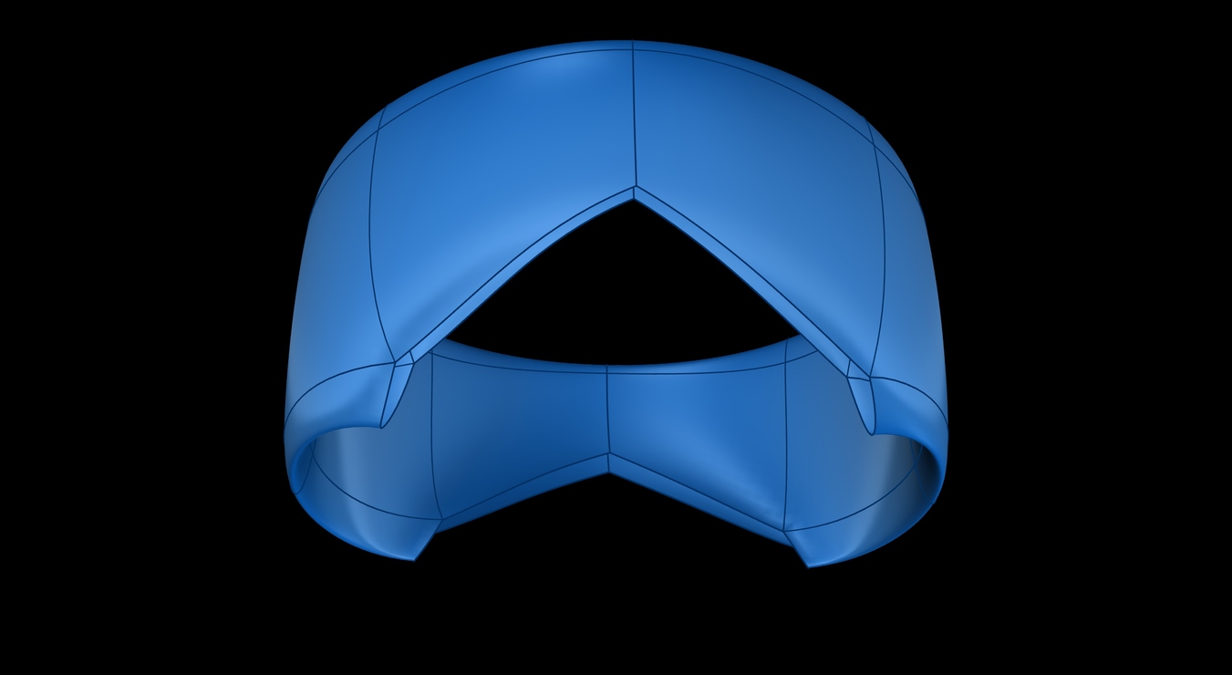

Here’s the simplest example I’ve had break _OffsetSubD so far:
I think the problem condition is the X intersection between two holes.
Offsetting them, with the “solid” option does this:
Note that there are holes in this SubD, but whatever’s going wrong has also broken my pink naked edge color. The properties panel says it’s an open SubD, but I can’t use _Fill on anything that appears to be an opening.

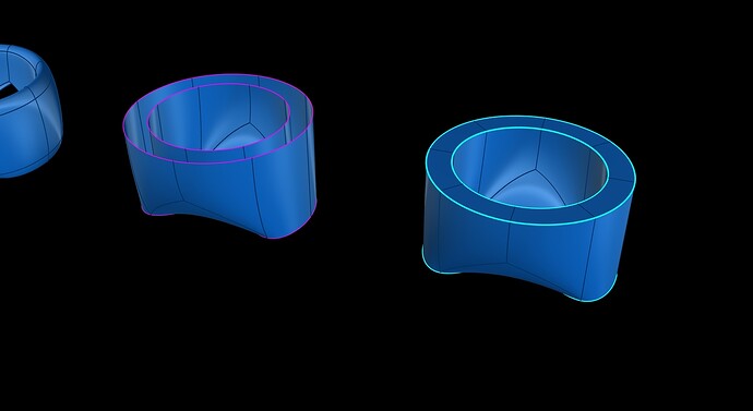

If I offset this object without picking the “solid” option, I am able to get what one would expect to be the result. and I’m able to bridge the two SubDs into one:
Though at the X intersection holes, when I bridge with the crease option, there’s one crease on the inside the X that happens when it shouldn’t.
Obviously, as with offsetting polysurfaces in Rhino, I don’t expect perfect results every time. But this is a very simple condition that maybe can be addressed. The bridging quirk is really minor, but the inability to do a solid offset with a usable result when adjacent holes have an X intersection seems like something worth fixing.
If anyone at McNeel is curious, here’s the file: These Pants Break OffsetSubD.3dm (233.4 KB)
@Gijs - Yep, once I subdivide the SubD twice I am able to get a closed offset.
@Max3 - Wow, thanks for doing this. Your file illustrates the bugs in I’m experiencing with _OffsetSubD better than my example. Also, your the black/blue scheme is rad!
I had already done most of it. Just broke it out into before and afters. It was the beginning of a drawer knob design I’m going to CNC out of walnut.
Your bugs are more complicated than mine, and Gijs is probably giving you more useful information for your problem.
But if you have time, see if you can cut out small sections of your objects and replicate the same problems your having in a form where we can isolate individual different conditions that cause failures.
