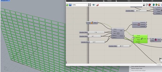

Hi, I’m building a parametric brick wall. I’m following a youtube tutorial that builds the wall from a rectangular grid, but I want to use a surface I have in Rhino. How can I obtain cells from the isotrim to offset the edges and form the bricks? Thank you!
The first script is the one I’m building and the second one is from the tutorial
as long as you surface is planar and has evenly distributed control points, this might work:
Thank you it works, but I ran into a problem later on in the script. At some point I get many lists as data and this part where I want to shift alternating rows is not working. Do you know how can I fix it? I tried to flatten the list, I think it works but I don’t understand how to shift it to the middle of the next brick

the rectangular cell component outputs cells branched by columns:
you can get a similar data tree by with something like this, which will directly create the data structure you are looking for:
brick wall (1)_Re.gh (25.5 KB)
or with something like this, which partitions the UV domains in branches, where U domain is constant along each branch:
brick wall (1)_Re_Re.gh (26.4 KB)
final result (in both cases):
