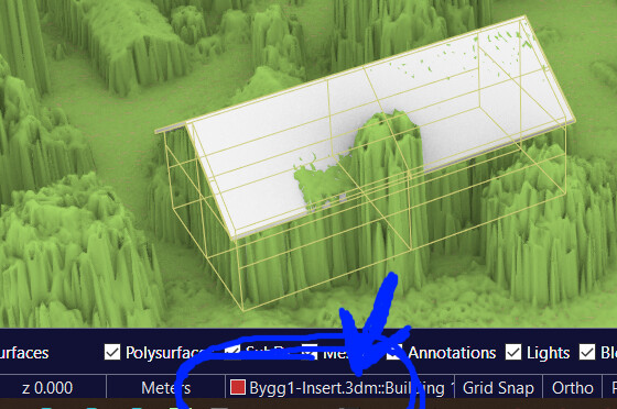

Hi Joseph -
That information is available on the status bar:
The complaint about that bit is often that you don’t see the entire layer name but you only need the first part. If the file name is too long to fit in that space, you can hover over it with the mouse and the entire name will be shown in a pop-up.
That’s just what I was looking for Wim, Thanks! On this project the NA insists on using some US Navy/Govt procurement protocol on file naming that has 22 characters as a prefix before you really get to the actual part of the name that tells you what it is. I didn’t know your trick about hovering over the title bar to ‘drill down’ through all the preliminary BS in a name. You have saved me much time with this tidbit of object display wizardry!
