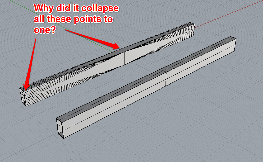

So I am trying to figure out the best setting to get some what decent meshes from my Rhino Nurbs objects.
So using the default setting the Nurbs rectangular tube is divided up fine but has collapsed all the points in the center to one edge. Why didn’t it just connect the points from one side to the other is straight line? Is there a setting in the advanced dialog to get it to not collapse the center points.
Hi Dennis- Try: add a max edge length and/or minimum initial quads setting in the detailed controls.
