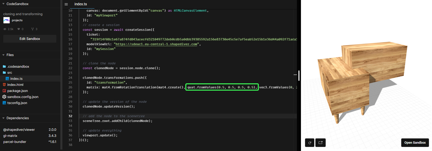

Hello!
Based on your transformation exemple (Move), i would like to make a Rotation instead but i don’t know how to set angle in Quaternion format ! Could you help me to format Quaternion in mat4.fromRotationTranslation() section please ?

  const clonedNode = session.node.clone();
  // add a transformation to it
  // clonedNode.transformations.push({
  //   id: "transformation",
  //   matrix: mat4.fromTranslation(mat4.create(), vec3.fromValues(0, 25, 0))
    matrix: mat4.fromRotationTranslation(mat4.create(), Rotation Quaternion, vec3.fromValues(0, 25, 0))
  // update the version of the node
  clonedNode.updateVersion();
  // add the node to the scenetree
  sceneTree.root.addChild(clonedNode);
  // update everything
  viewport.update();
Better, but how to rotate 90° on Z axe please ?
Solved:
quat.fromValues(0, 0, 0.7071068, 0.7071068)
I’ve used 3D Rotation Converter to find it ^^
