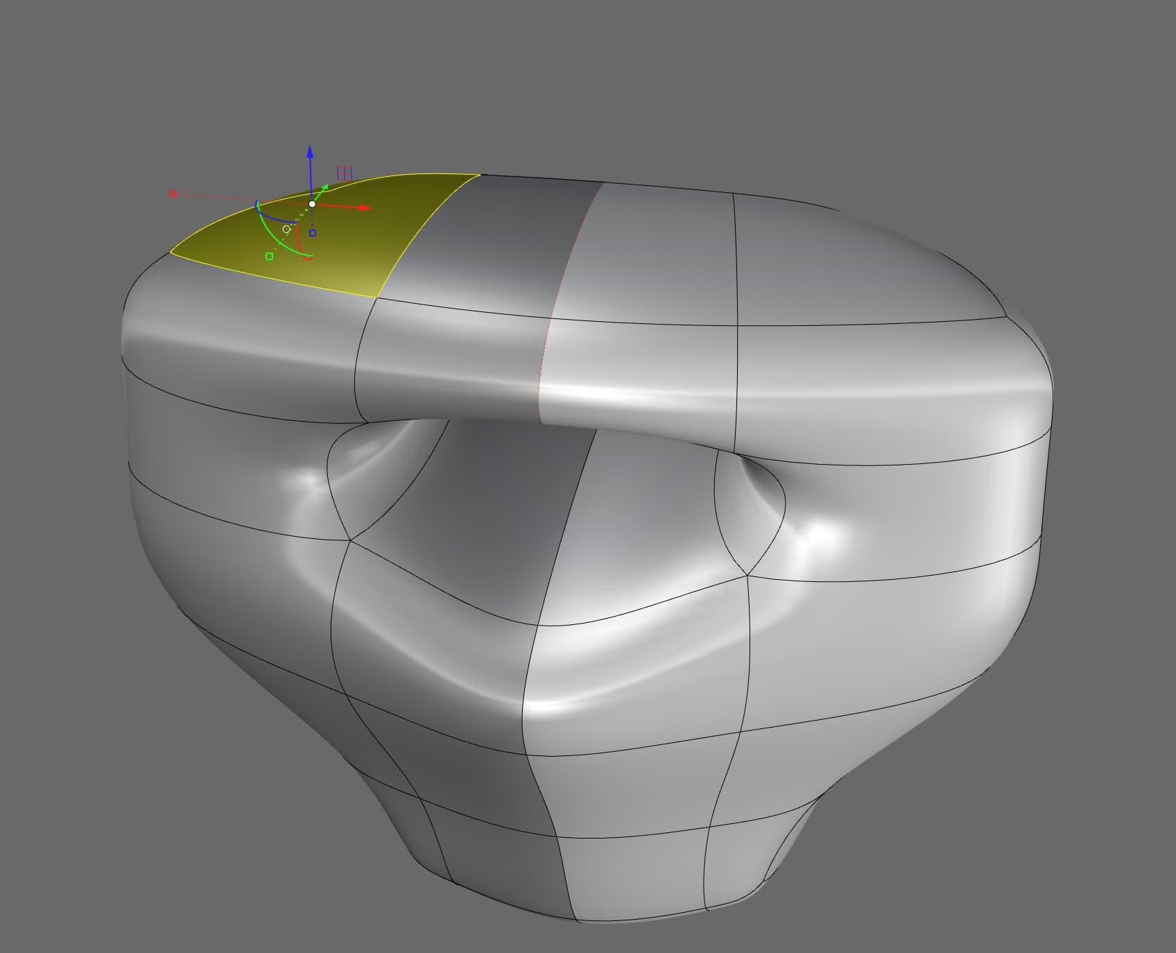

Now an action in one side is reflect on the other, this happening in both master and slave sides,
(no more Parent and Child sides)
Is this supposed to happen ?. No problem for me
Cheers
Joao

Topological changes can be done on the master side only. Transformations can be done on both sides. For instance when using the Gumball to extrude a face, you only get a dot to pull at on the master side.
Thank you for the clarifications, but if I remember well, even transformations were not possible on the Child side before
Cheers
Yes, in the beginning you could only edit the master side. I think this might change and at some point everything can be done on both sides.

In the Reflect command it only says primary side. Topological changes can be done on the primary side only, whereas transformations can be done on both sides.
