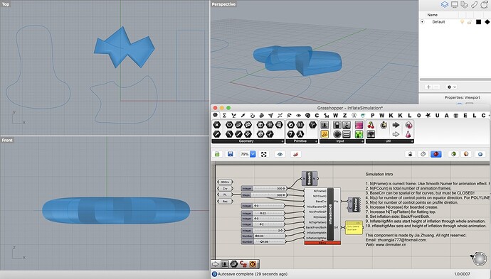

Function: Feed a closed curve, it returns a inflated surface with inflating animation.
  1. N(Framei) is current animation frame. Use Smooth Numer for animation effect. Right click to set duration.
  2. N(FCount) for total number of animation frames.
  3. BaseCrv can be spatial or flat curves, but must be CLOSED! For BaseCrv is POLYLINE, set N(u)=0.
  4. N(u) for number of control points on equator direction. For BaseCrv is POLYLINE, set N(u)=0.
  5. N(v) for number of control points on profile diretion.
  6. Increase N(Crease) for boarded crease.
  7. Increase N(TopFlatten) for flatting top.
  8. Set inflation side: Back/Front/Both.
  9. InflateHgtMin sets start height of inflation through whole animation.
  10. InflateHgtMax sets end height of inflation through whole animation.

Here is a new inflation simulation component. Load a closed curve into “BaseCrv”, it gives an inflated balloon surface, and it is untrimmed! Use “Smooth number” to view animation effect.
Welcome everyone to explore the component and leave your comments.

Thank you for your suggestion. I added more options. Now can customise profiles, and support polylines.

Thank you for your feedback. I updated my component, your crv is working now. please check the new file. InflateSimulation.ghx (200.2 KB)
Thank you for your feedback and support. A new version is uploaded. Many new features are added. Please check the main post.
