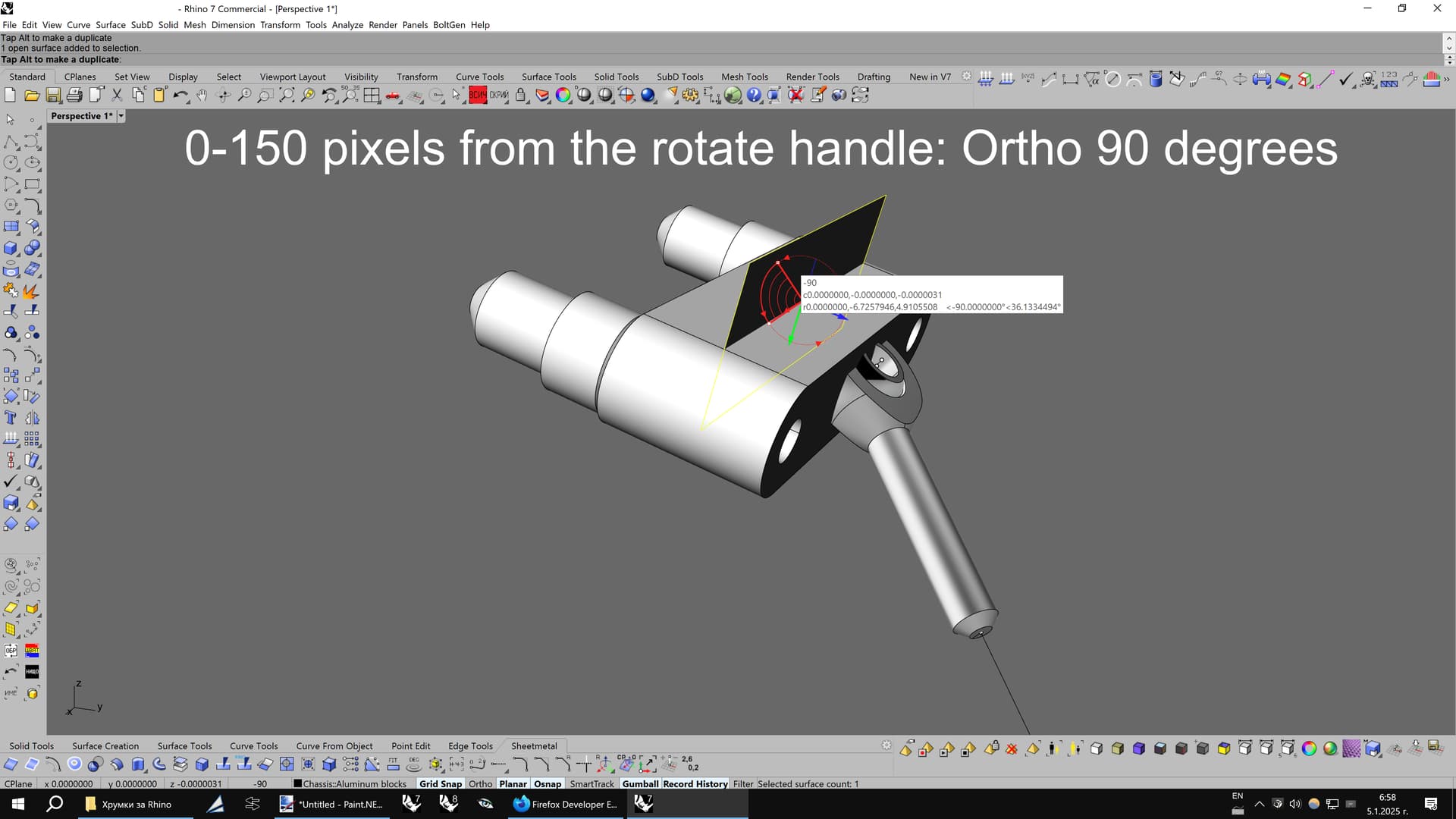

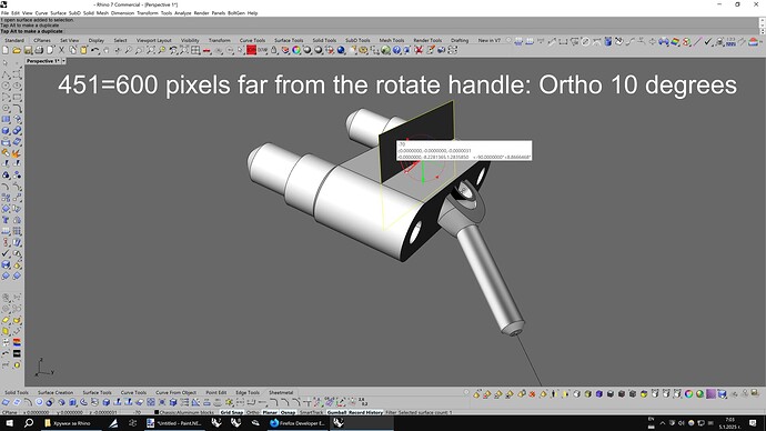

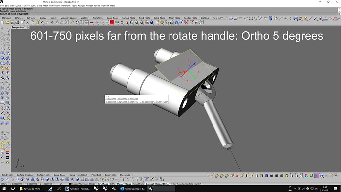

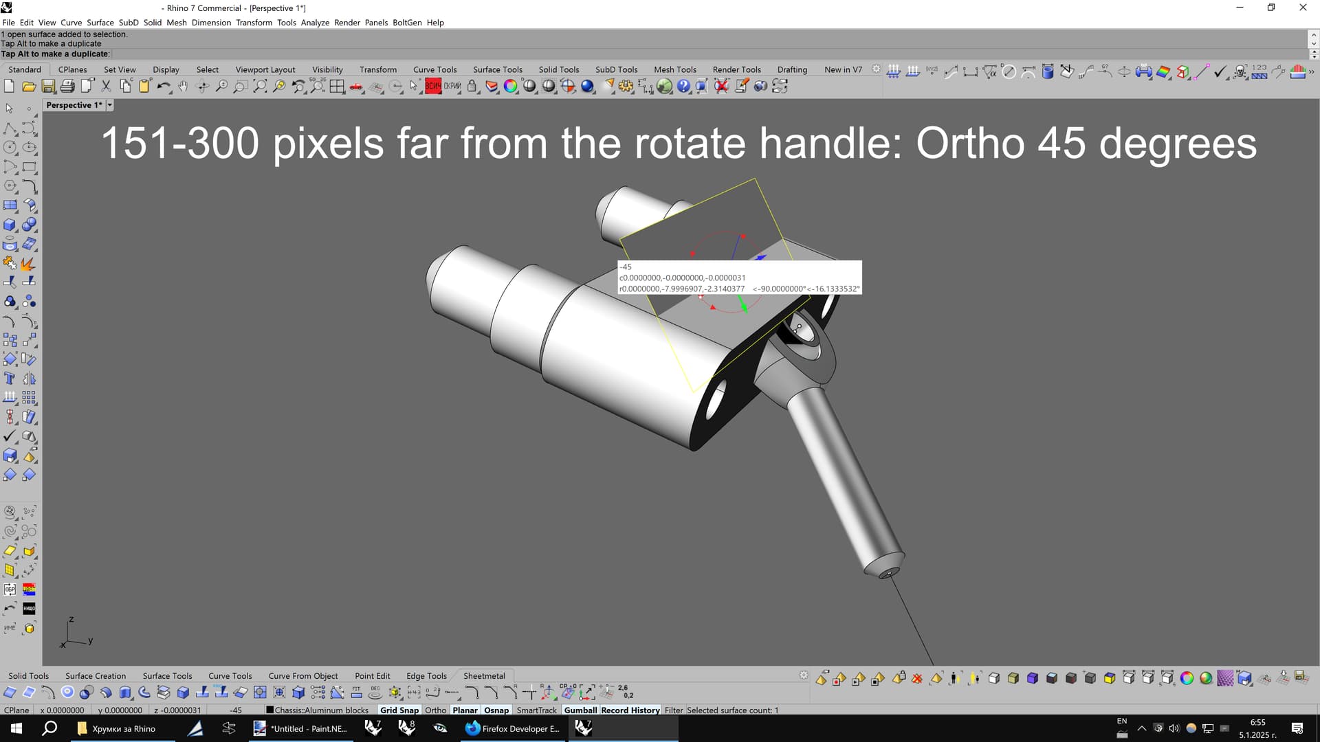

Here is my latest proposal for upgrading the current Gumball. This could be an optional setting that lets the user activate the “Dynamic ortho” feature of Super Gumball. As the name suggests, the ortho angle for rotating with the Gumball will switch dynamically depending on how far the mouse pointer is relative to the active arc handle.
When the mouse pointer is close to the arc rotate handle, the ortho angle will be more strict at 90 degrees.
If you drag the mouse pointer away from the rotate handle, the ortho angle will get a little bit loose at 45 degrees.
If you drag the mouse pointer even further away from the rotate handle, the ortho angle decreases accordingly.
Once you move the mouse pointer 1001 pixels away from the rotate handle, the ortho is deactivated, hence the rotation is totally free (just like holding the Alt key when Ortho is active).
Optionally, a pattern with circles could be temporarily displayed while rotating with the Gumball, in order to visualize the borders of the ortho angle zones. If pixels is more difficult to program, then the default units in Rhino could be used for displaying 2d circles aligned in the same plane as the active rotate handle.

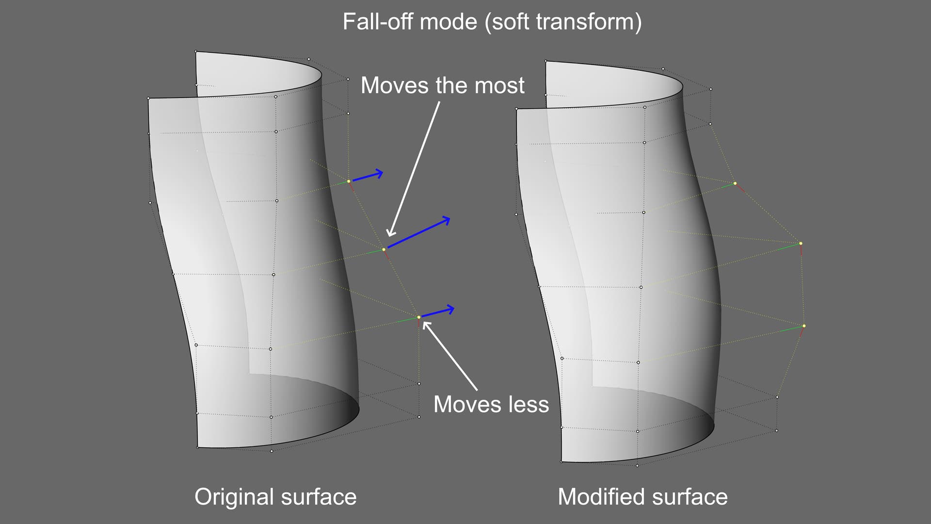

Does that mean that the aligned control point arrow handles handles only apply to a single control point? Any chance to make it work with multiple control points, so that dragging a single arrow handle will move all the selected control points in the same control polygon direction (not to be confused with “same direction”). I mean, every of the selected control points should move along it’s local control polygon.
Also, there must be an option to add a fall-off mode (sort of a soft move along the UVN directions), so that dragging the arrow handle of one of the selected control points will affect all the adjacent selected control points at a lesser degree. This should NOT affect the rest control points that are not selected. The idea is to keep the non-selected control points intact, while the selected ones will be moved gradually in a smooth way.
I’ll make an announcement post soon about how the gumball UVN mode works. I’m currently figuring out how to get SoftTransform falloffs to work with the UVN aligned gumball. SoftTransform currently affects vertices/grips which are not selected. We may need to add an option to only work within the selection.
Yes, it’s a much needed option to affect only the selected control points, in order to maintain the G1 or G2 continuity with the adjacent surfaces or just to limit the transformation to the desired region.
