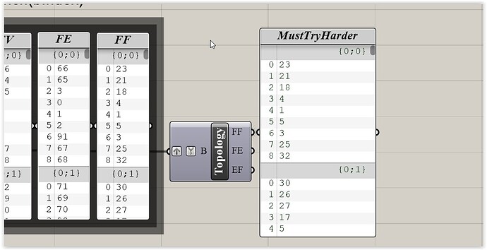

Assuming that you have an idea about what a DataTree is : kinda a dictionary of Lists (well … kinda) Connectivity is a Tree of type int that relates items in one or two Lists.
For instance a VV Conn (V for Vertex) relates items in one List. Path dim 2 (or 1) is the index of the parent item and the items are the indices of the child items.
On the other hand a VF Conn (V for Vertex, F for Face) relates items in 2 Lists (Vertices against Faces). Same for EV used here (Edges against Vertices).
So using solely the VF Conn Tree … we search for Vertices connected with just one Face - like V48 (belongs to Brep 3) that is connected to F37 (obviously in Brep 3) … blah, blah. All that are elementary via code, mind.
In most or real-life cases Conn Trees have 2 dimensions (first is the index of the “parent” item in the List [the Brep in the bList for this case])
Since for Breps/Meshes we have 3 classes of objects (V, E, F) … there’s 9 possible Connectivity Trees (VV, VE, VF, EV, EE, EF, FV, FE, FF).
Here’s the full 9 Trees:
Your first surface has nasty two interior vertex that are also retrieved by this approach.
