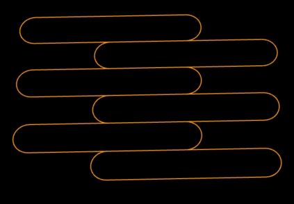

This could be a start on a solution:
Screenshot_1
or maybe just a trip down a rabbit hole.
unnamed.gh (13.3 KB)
Interesting, I will try to use shatter lines, then get some connection lines, and finally offset polyline.
Here is a way to replicate that, not exactly, there are surely others parameter involved in order to achieve better looking.
This use mainly the graph mapper and proximity.
