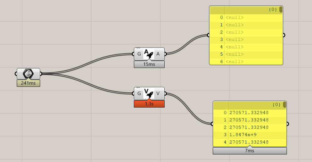

After much head-scratching, I figured that the strange behavior of my definition could be traced back to your component :
I realize that it doesn’t account for empty branches, and thereafter, the data is completely shifted in the tree.
Turning off parallel computing, or feeding a tree without any empty branches solves the issue though.
Could you check that out please ?
Parallel computing doesnt handle empty branches.gh (1.4 MB)
BlockTools.gha (56.5 KB)
Hi @osuire,
I don’t have have access to the code in BlockTools.gha. But might make sure the code never returns null or nothing. In cases where the input is null or the area/volume cannot be computed, you should always return something, perhaps RhinoMath.UnsetValue.
if (null != result)
  data.SetData(0, result.Volume);
else
  data.SetData(0, RhinoMath.UnsetValue);
– Dale
