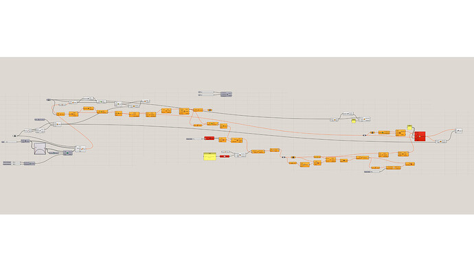

Hi, I’m creating a parametric lattice shell for a surfboard rail in Grasshopper. The goal is a lightweight, ventilated structure that accurately follows the rail shape
The lattice doesn’t follow the surfboard shape accurately, and I’d like more control over the generated pattern. My goal is to input a surfboard’s length, width, and thickness and have the lattice automatically adapt. Could someone help me understand what I’m doing wrong or suggest a better approach?

Looking at the model, I think the way to generate that lattice is to create a series of curves on a Brep that represents the rail and then using implicit surfaces to create pipes and merge them with the face that meets the board (this can be achieved with Isopod or Axolotl). I’m not entirely sure how the curves where generated, but there are ways to get similar results. Given the struts seem to use the same angles and meet at roughly equal points, I generated the lattice and mapped it to the ridge Brep.
The script is quite complicated (I would have made a simpler script, but I do not have the time right now)

Looking at your example image, I think I’d play with generating a specific ‘soft surrounding shape’ then apply lattice works afterwards—many thoughts come to mind.
A quick try:
surfboard.lat.gh (38.6 KB)

Improved version*
surfboard.lat2.gh (48.2 KB)
*Previous one uses a half circle as guide for the sweep profile curve—latest one skips that and makes the splines instead. I’ve kept the shape ‘uncapped’ for now
