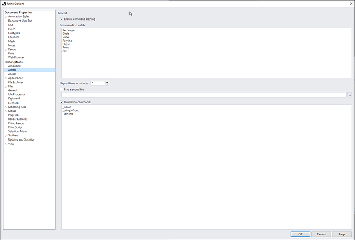

Need 'bring to front' on all curves drawn as I draw them?
Move everything below Z=0 with a fixed distance and back when done. Or learn how to use the cplanes. It’s easy and fast once you do.
Try this:
Options >Alerter:
Enable command alerting>ON
Fill in all the commands that you use for drawing, here is a start list, but fill it as you go:
Rectangle
Circle
Curve
Polyline
Ellipse
Point
Arc
Rhino will listen to those commands. When you use one of commands in that list, rhino will trigger a response after it (every time) and will do the following:
_sellast
_bringtofront
_selnone

I have done that exact as per screen image, ticks as same.
time set to zero.
draw a line but it doesnt appear.in front if the mesh.
open panel and 0 is now 1, make zero, ok it, draw line, no better, open panel, its now 1 again.
I am not getting a bring to front on a simple line.
what is wrong ?
Also what code is required to have this work on the result of projecting a line to a mesh or solid or surface ?
Steve
Pawel’s solution is working on my R8. Try 0.01 minutes not 0. I was going to take a screen shot but it rounds to 0 (but it’s not really zero). Try setting it to 0.01.
Also add “line” to the list of commands. Any command you create a curve with needs to be added to that list.

Add “line” to the list as @Keithscadservices suggested + add 0.01 to time.
Please note that there are other commands that I forgot, so you need to update the list as you go. For example, I also forgot “Polygon” and "InterpCrv’…
