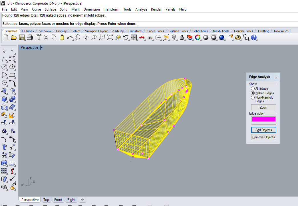

i made a rectangle, than patch it by patch command…now i checked naked edges, i have 4 naked edges…how to remove or fix these naked edges??? I am attaching my photo here of geometry
 ![naked%20edge](https://global.discourse-cdn.com/mcneel/original/3X/6/c/6cfcd2da655072263eaf46fb99278a8230666ea2.png)

hey…thanks helvetosaur…but i made hull shape and i have lot of naked edges…so i want fix them…but i dont understand what its use…why i shld fix them???(some people said to me to check naked edges)…can you elaborate more about naked edges
 ![naked%20edges](https://global.discourse-cdn.com/mcneel/original/3X/6/a/6a62f2127a295f613bdffa05f262a67dd5f5eab3.png)

Hello - if surfaces are meant to be joined (Join command) then the edges must be within the file tolerance - in the file you posted elsewhere, the edges are not nearly close enough to join- one pair I checked at random had a deviation of more than 4 units. It’s probably worth learning a bit more about how Rhino works -

Any surface that has edges that are not joined to another surface (or itself in the case of closed surfaces) will show those edges as naked, yes.

BTW, @tumulpurwar - instead of using Patch to make a surface from a closed planar curve like a rectangle, use `PlanarSrf` to make a simpler surface.
