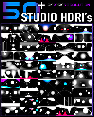

with great pleasure.
first of all i downloaded these hdri images.
from this site.
they are for reflection and lighting (studio style).
it cost me 16 dollars.
I’m afraid to share them, since I haven’t read the distribution and copyright rules.

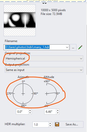

here is the reflection image Inkedbig_b64a380fd1c_LI
I played with these parameters to find the right angle of reflection.
it’s a matter of taste.

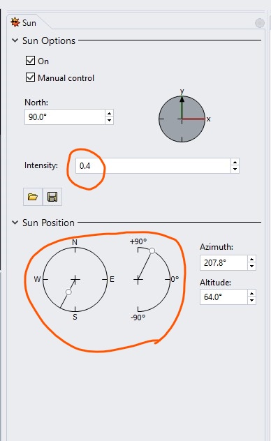

also sunlight. intensity 0.3 or 0.4
in short, I position the sun on an angle, where its reflection is seen on the object.
the ideal place is often in the bright area of ​​the hdri reflection.
this adds nuances and gradients of colors on the area exposed to light
the intensity of the two lighting modes should generally not exceed 0.5 for each.
