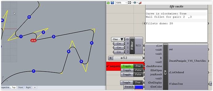

Fillet is not nuclear science … but requires a lot of checks not only related with the result itself (i.e. if a fillet is possible) but with the “reverse” situations as well. Study these indicative captures (with or without the checkReverse option).

Any hints for reverse checking ?
Are you familiar with C#?
