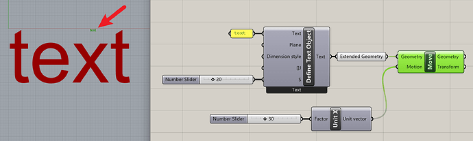

Does anyone know why text size is not retained when moving Elefront text in grasshopper?
My current workaround is to move the plane, then have another text component when needed OR feed in all points for text to a single text component. Simply moving the text would be a much simpler + more ideal workflow.
I’ve added the extended geometry component for better preview visibility, so the issue persists when strung straight from the define text component.
Any help on this would be much appreciated!
It’s a bug! We’ve got a fix which we’ll be rolling out with some other updates in the next few weeks.
Awesome! This will be a massive help. Will the fix also work for the older version for Rhino 7?
