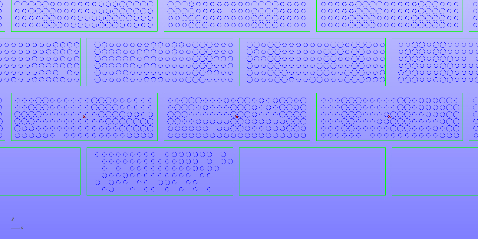

I am trying to move multiple groups of circles (seen in picture) from their respective centroid to another nearby. (the centre of the green rectangle differs from the centre of the circles bounding box)
my gh code starts off strong, bounding box/area/pt. but I can t seem to nail down the move part. it either moves way off target or leaves some circles behind or stacks the circles all in one place
I have attached where I am up to after 4 hours and mutiple deletions/attempts - I am sure you will all think its ugly but I’m still learning…right?brick circle orientation.gh (32.5 KB)

simply put, I have circles (in rhino groups) I need to get them to be centred in the boxes identified at centre points 1,2,3.
My current “move” component send the points way off when it should only be moving 8mm or so and I cant understand why… but I know the computer is right - and i’m thick…
I know its a centre point creation of the circles using bounding box, then find centres, then move to closest point. I just can’t close the deal…been all over the forums, looked at videos, internalized friggin everything (!) …tried a bunch of things, 4 hours later still lost. any tips appreciated.
