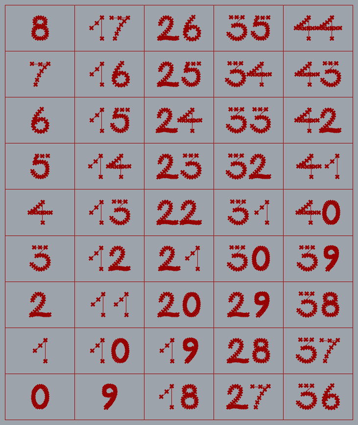

So I went to the trouble of implementing that strategy, removing font points that created vertical lines and using multiple paths (strokes) to make IntCrv work properly. Had to fix gaps in “0” and “8” by duplicating their start points because making IntCrv periodic isn’t appropriate here.
Only four digits are single path now: 0, 6, 8 and 9. PLine has been removed.
Caligraphy_2024Oct7b.gh (85.7 KB)
Way simpler and better in my opinion. Robot control software will need to enter and exit each path vertically - or not, when the next path starts where the the current path ends,
This finally addresses most of the issues that kept me away from working on this project.

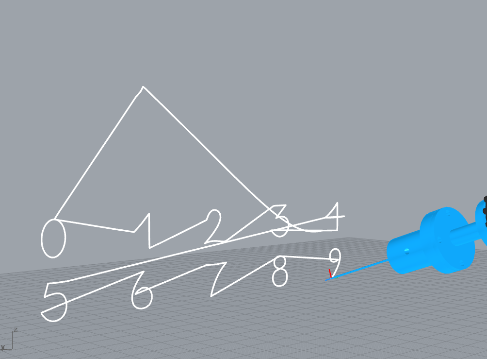

Robot following point sequence without lifting :
Lifting line sequences at start, end is not resolved in some:

Joseph, took me a while to get through all your code, I made a few adjustments to the grid direction (reads left to right, then down) and it now all works fine apart from the very last sequence, where I need to lift the brush when one number is finished to move it to the starting point of the next number, which hovers above the initial line sequence. As there is a mixture of line/ curves to each number, I could so far not figure how to determine the last point in some numbers. Once this is resolved, this should finally work!

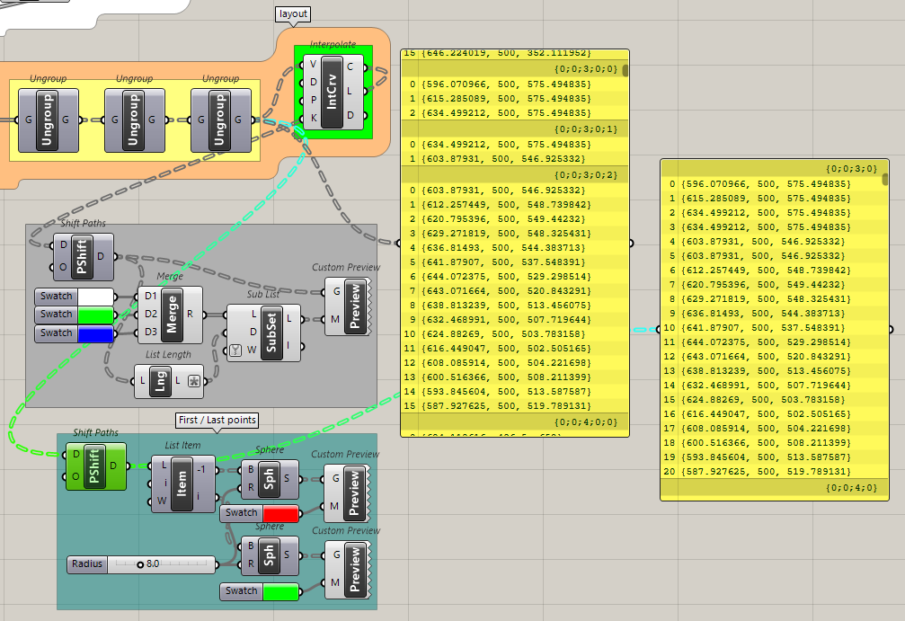

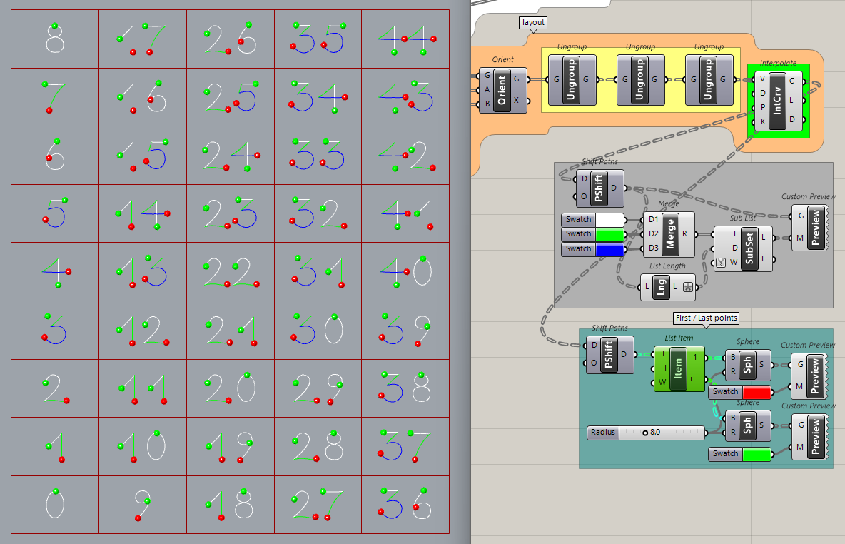

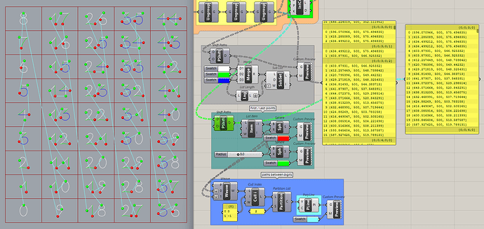

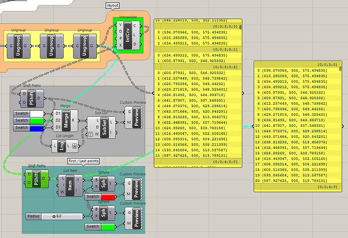

The teal (blue-green) group labeled “First / Last points” at the bottom right of this image places a green sphere at the first point and a red sphere at the last point of each digit. Those points are the same for “0” and “8”. Paths and points in between are sequential.

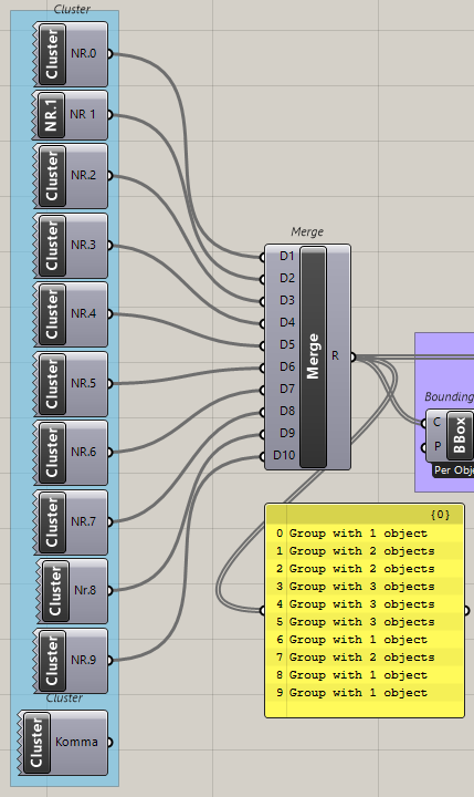

  • Digits with one path: “0”, “6”, “8” and “9”
  • Digits with two paths: “1”, “2” and “7”
  • Digits with three paths: “3”, “4” and “5”

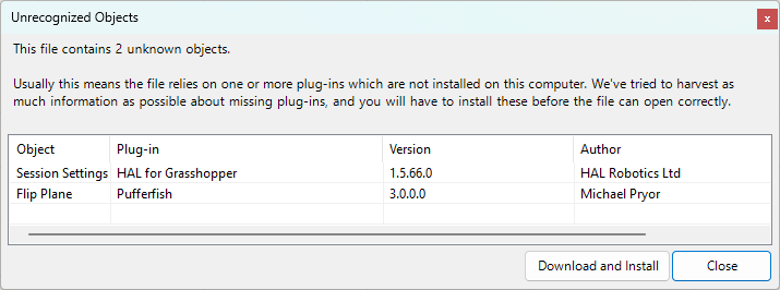

Probably not as much time as I spent writing it? It’s unfortunate that you modified the grid instead of just adding robot code to what I wrote. I don’t have Pufferfish.
All orange components in this image are disabled because I don’t have Pufferfish Flip Plane when there is no need for it. GH has a standard PFlip.
Looks like you also replaced the R7-compatible Area component with the R8 version so R8 is required now. :frowning:

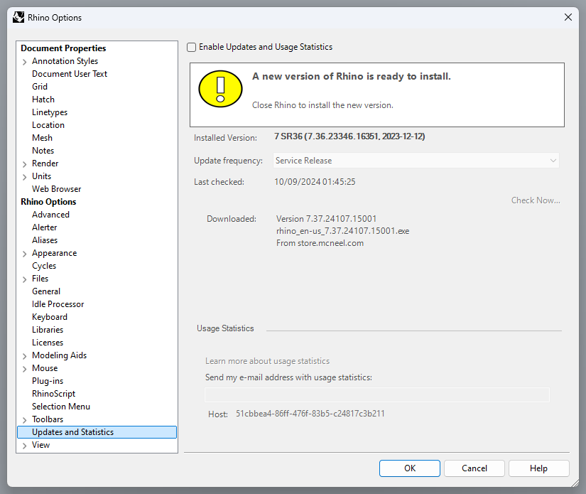

Hi Joseph -
Yes, and that (amongst other issues) is why, after 4 weeks with service release candidates, 7.37 was released 5 months ago.
I checked before I posted an hour ago and it said I was up to date, now i see this:
So will close R7, install the update and look again… Hmm, it doesn’t seem to work that way, how do I install this new version? Always an adventure… :roll_eyes:

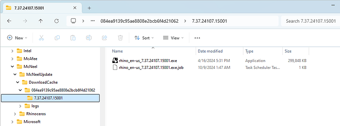

Hi Joseph -

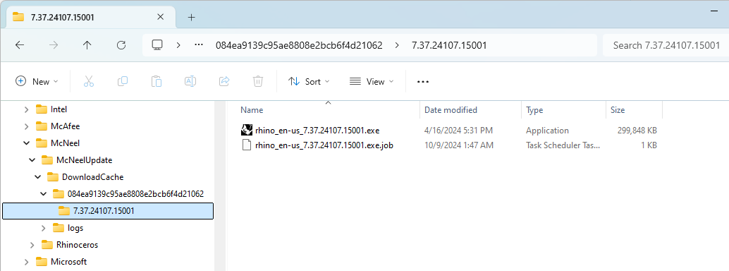

You don’t have “Enable Updates and Usage Statistics” checked.
It does say that 7.37 is downloaded, though. That means that you should find a 7.37 exe file in one of the subdirectories in C:\ProgramData\McNeel\McNeelUpdate\DownloadCache.
I don’t want to participate in Usage Statistics.
Way too much trouble :bangbang: Thanks anyway. Why is it so difficult :question:
I suppose we all make our choices and end up where we are…
McNeel has made choices that make updates conditional and difficult.

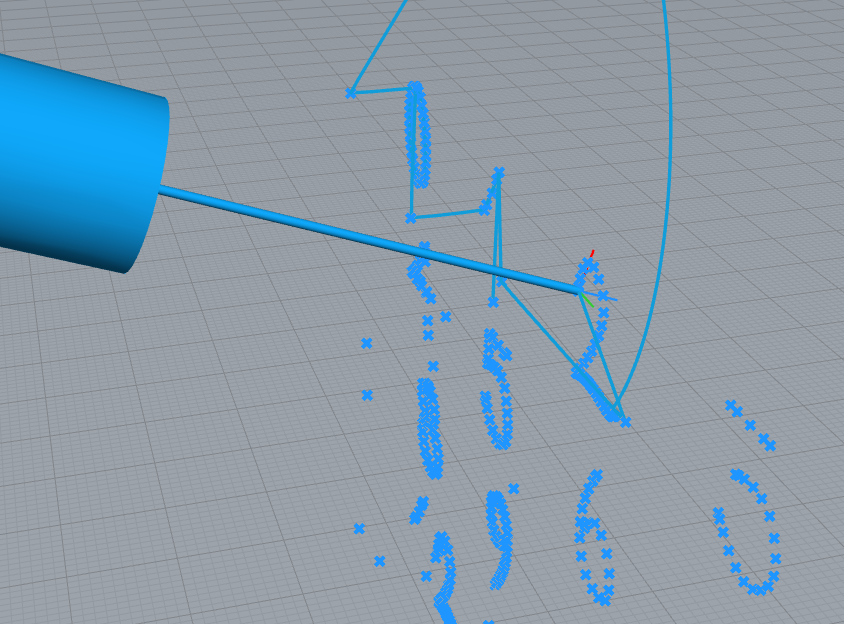

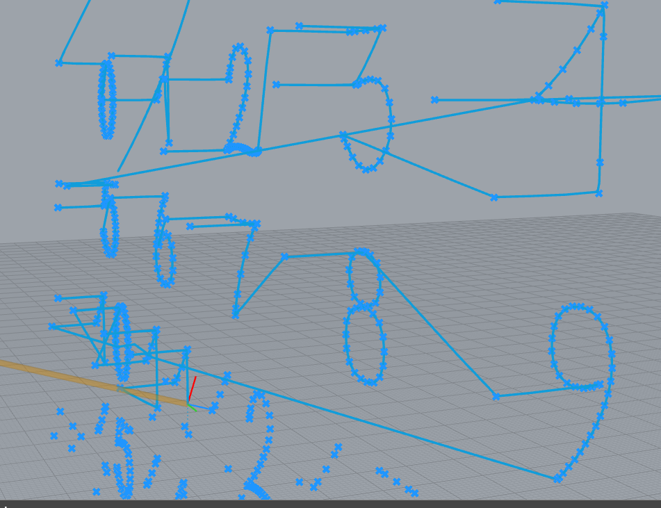

Now, the robot doesn’t accept the data structure I give him, the start, curve and end points follow first branch in all data trees.(start point, first branch of each digit, then it moves to end point, from there to start again (same with if I only use the start and digit (as in number) data tree. So the 0, 6, 8 and 9 work… ) I think I need to split the group again into sub groups ( perhaps again 0 to 9) or into how many paths they have ( as you eluded to above).
I have to say that this is gradually getting well beyond my pay grade, skill wise, I attach the screenshots which hopefully illustrate the problem. I have to take a break from this for a bit as I will be out of the country until next week, again , thanks so much for your help ( but equally understand if you leave it here) ,
Apologies for using third party plug ins, I was not aware of it. I do work in R8 , it has good improvements, I teach basic Rhino and GH to my sculpture students hence I need to use the latest version.

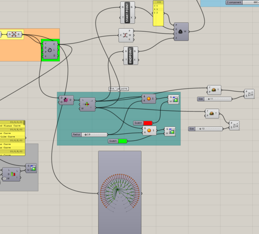

I was surprised to see you using control points from my IntCrv output and ignoring the points from font creation (used by IntCrv) that I had so carefully labored to preserve. If that works best for you, we could have more easily generated a group (for each digit) of 1, 2 or 3 path curves instead of struggling with the points.
As you can see in this image, PShift in the teal group consolidates all points for each digit into a single list that allows me to get the first (green sphere) and last (red sphere) point for each digit.
The paths and points are in sequence so there is no reason to lift and lower the robot between paths in each digit. That makes sense only when moving between digits (red to green spheres). See the cyan lines between the end and start points for each digit in this image:

thanks for reply, it is EXACTLY the point what I have to do, " lift and lower the robot between paths in each digit"! I am writing this not with a hard tipped pen or pencil, but with a soft tipped ink brush, so artistry is the problem, as the code has to accommodate the lag in between the strokes.
If I go from start , through all paths within a a digit, the lag in the brush will not paint the digit correctly, it will round all corners, so a Nr.7 will end up looking like a bit like a ), (a kinked hook, a Nr. 2 will end up more like mirrored “S”), they will never be sharp.
Imaging you have a pointy ,soft tipped brush, you move every stroke in and out of the paper, and in the middle of each stroke you might need to apply more pressure for the stroke to look nice ( go x/y negative at midpoint) , the angle at start finish might have to be changed in order for the tip to enter and leave the page nicely. The robot has to mimic all movements a human hand does when using a brush for numbers, hence at the very start I broke all curves up in segments with up and down movement.

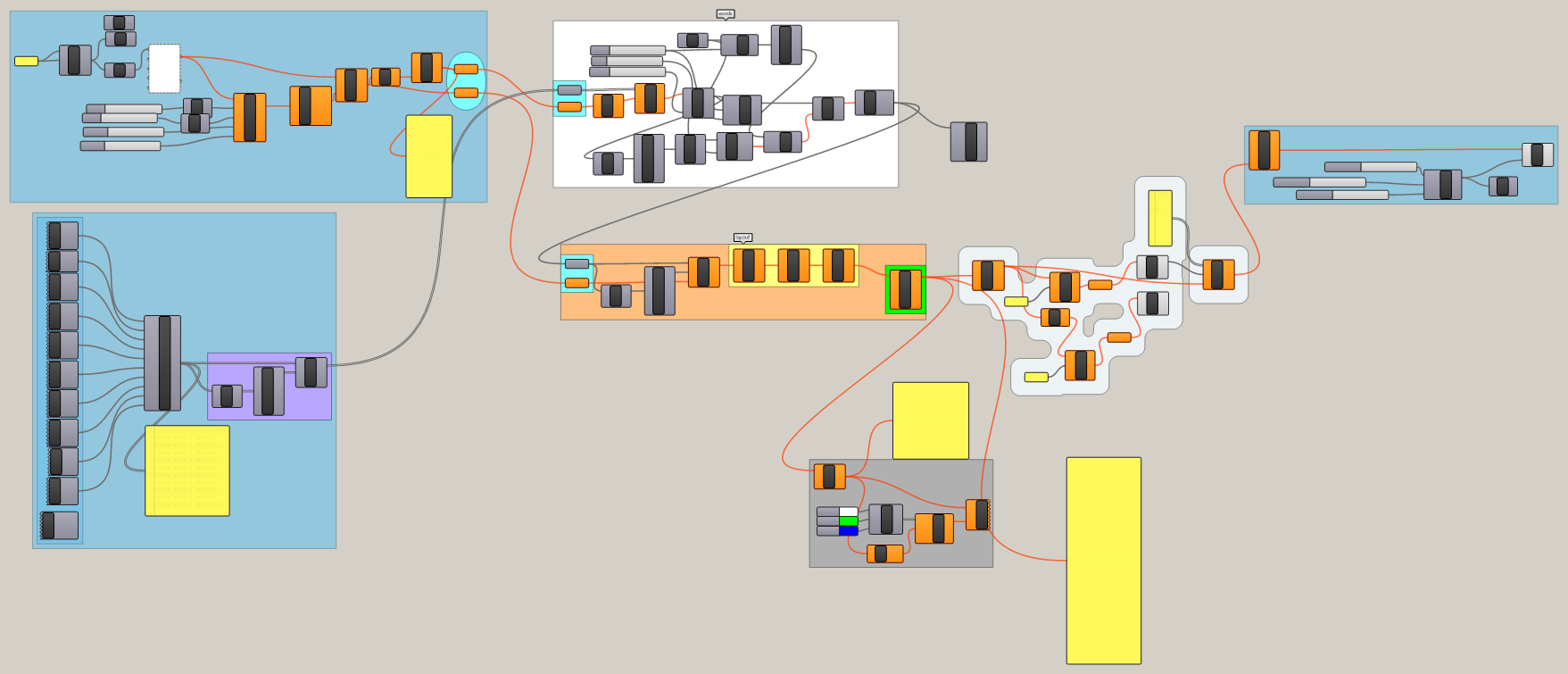

This somewhat illustrates it quite well :
I hope this makes sense to you , language is imprecise by it’s very own nature…
