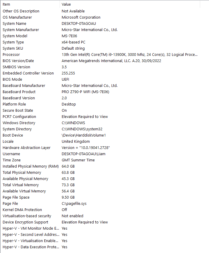

Attached System Info Screenshot.
Running on Windows 10 Pro. Graphics Card: GeoForce RTX 4080 (Upto Date Drivers installed)
Thanks
Liam.
os
Hi Liam - sorry, please run the SystemInfo command in Rhino.

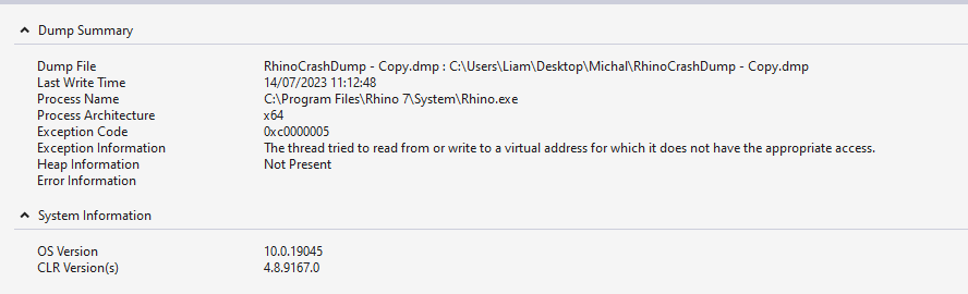

This is from the Crash Dump file. If that helps?
