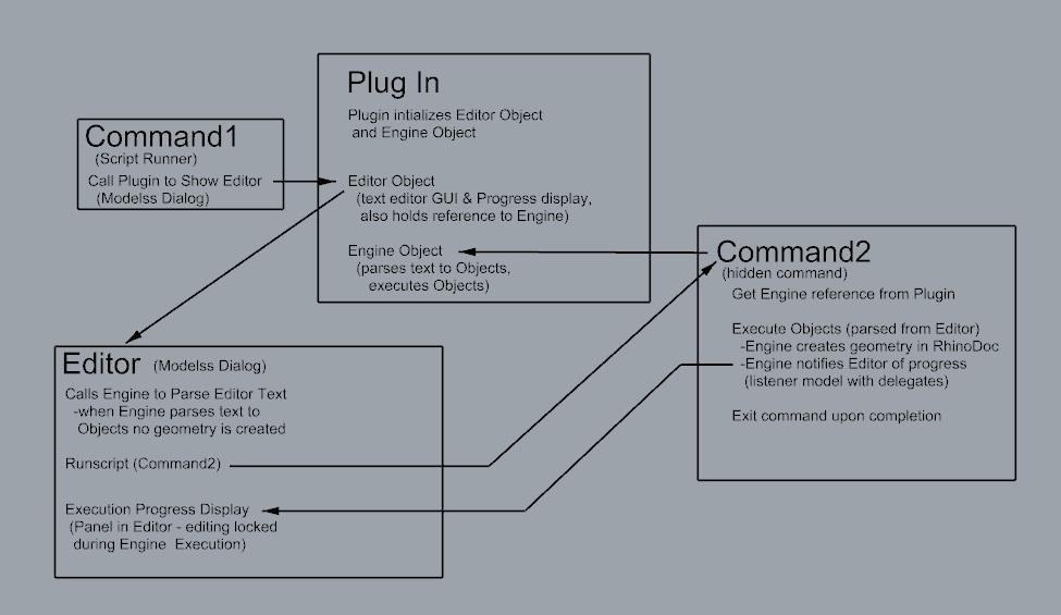

@stevebaer Would the attached be good practice? I also realized that currently I am creating geometry on a new thread. Would creating the geometry on a new thread started from command2 be ok? Would the command still be in the undo queue or would that break things?..
thanks,
tom
That looks like a good workflow. Creating geometry on separate threads is fine, but make sure to only add geometry to the document on the main thread since the document is not thread safe.
Cool - Thanks for the guidance!

I’ve restructured things, but I’m having a little trouble getting cancel to work (undos work nicely though). Previously, cancel was executed through the progress display panel and was nice and crisp. I’ve tried to hook up a an EventHandler for Escape keys, but I can’t get it to work running on the same thread. I have tried everything I could think of (event hook code is below in case I’m doing something horribly wrong), but the only way I got escape to work was to start a new thread from inside the Rhino command (Command2) and use a Thread.Join(), which wreaked some havoc on the progress display…
I tried detaching the listener (GUI updates) too, but that didn’t seem to help either…
Appreciate any ideas on this,
thanks,
tom

I would recommend using a GetString with a message “Press esc to cancel” on your main thread instead of the EscapeKeyPress event. This will put Rhino in a modal state where other operations can’t occur until the user presses a key.
Sorry - I think I confused the issue. Just to clarify, I have taken all the threading out of this now (I am NOT using the weird experiment with Thread.Join() - that was just a test to see if I could somewhere with the event). I am trying to follow your advice and make this as Rhino safe/friendly as I can, so currently, this is running on the thread that creates it. I think your last suggestion would work with a threaded form of “executeSystem(name)”, but I’m not sure it applies without a second thread if I’m understanding this properly…
I was playing around with a modal dialog last night (non-Threaded), but still no joy with the escape key event…
Face palm moment…
//call periodically in execution
System.Windows.Forms.Application.DoEvents;
That was the only thing holding this up.
Progress display, cancel, modeless dialog, undos, all working great and thread safe under the new setup per diagram…
Happy and relieved to have it playing nicely.
tom
Great! RhinoApp.Wait() should have the same effect since it lets the message queue get processed
