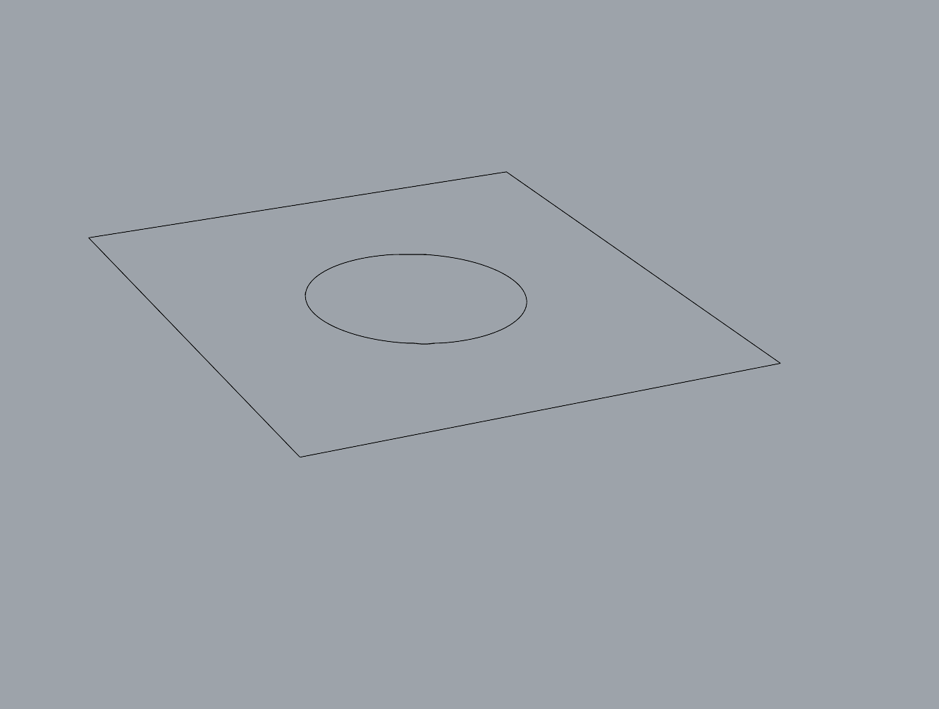

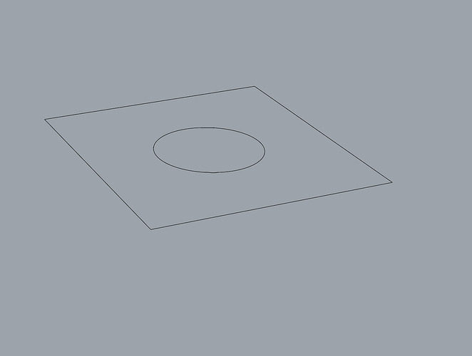

Model a hanging net from a square outer curve and a circular inner curve
I want to model a relaxed surface that is drooping slightly between this square outer curve and the circular inner curve (so there’s a hole in the middle)
Both of these curves are planar, so the net will droop slightly just due to gravity, depending on how “tight” the anchor points are.

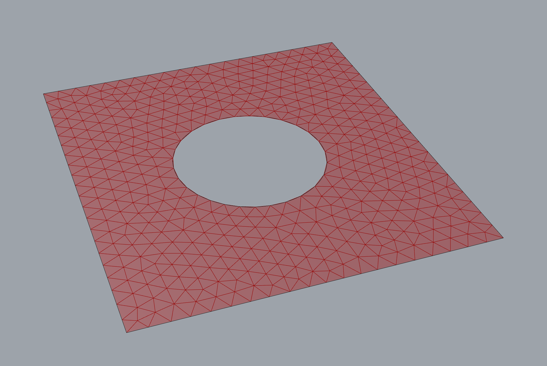

I’m assuming the first step is to create a mesh like so. I can extract the vertices that lie on the inner and outer curves which become my anchor points.
However from this point I am unsure how to proceed. If I feed these points into the anchor component, and the mesh into the “show” and "edgeLength: components, and then feed those into the kangaroo solver, the mesh doesn’t deform at all. I’m assuming that’s because it is only calculating how the mesh stretches between these anchor points which are all coplanar (so the resulting mesh will also be coplanar). I’m guessing I need to somehow add gravity as a factor in the calculation, since that force is what will actually cause the mesh to droop? or somehow simulate how the mesh “hangs” from these boundaries.
