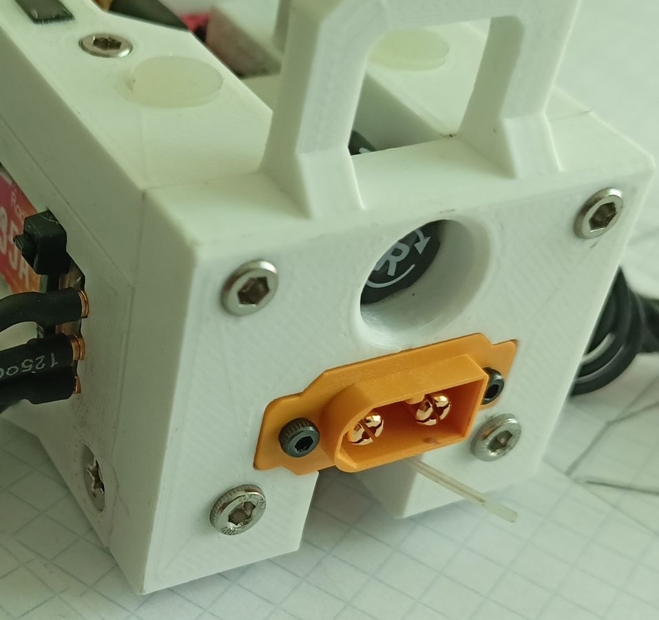

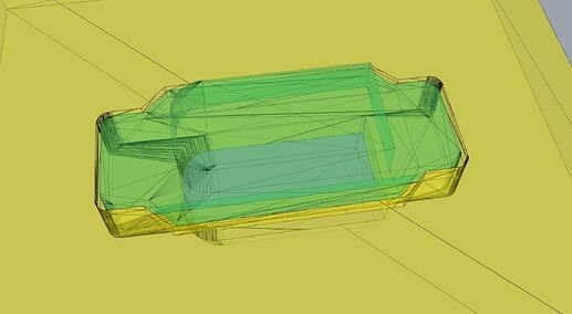

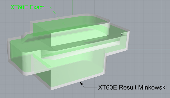

Case One:
The creation of XT60E socket, mounted in 3d printed plate:

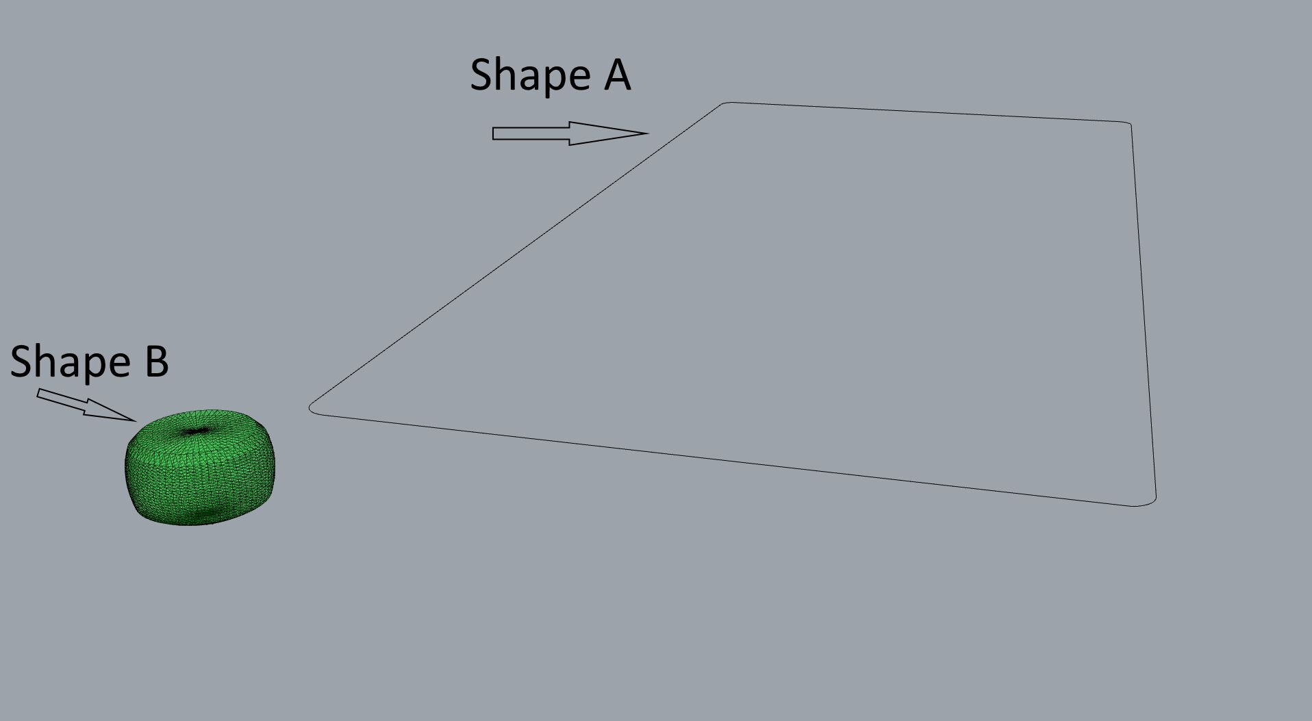

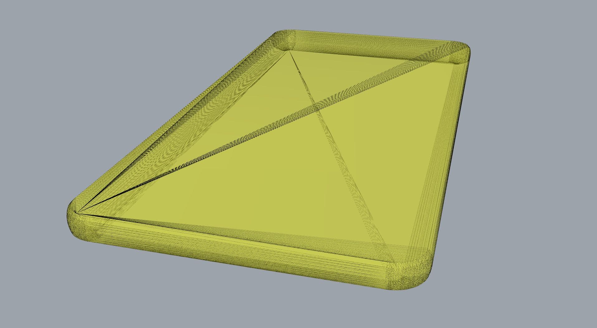

Case Two:
Perform minkowski sum between planar region and detal, for generic looking cellphone.

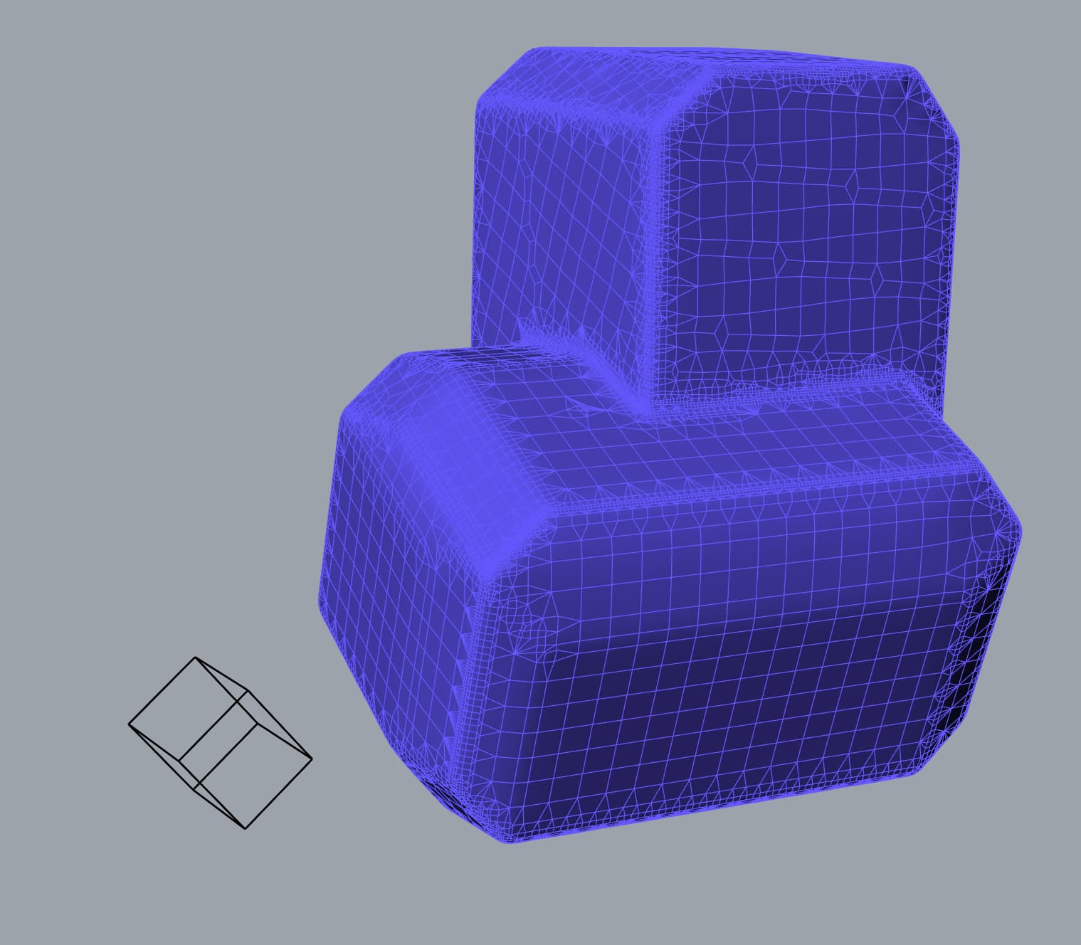

Thanks. I looked at the simple iphone example you posted before but for the subtraction of this plug I don’t understand the point yet. The geometry in the layer XT60E Result Minkowski appears to be an offset version of the exact geometry.
At least the iphone shape being all convex could be created with a convex hull too.

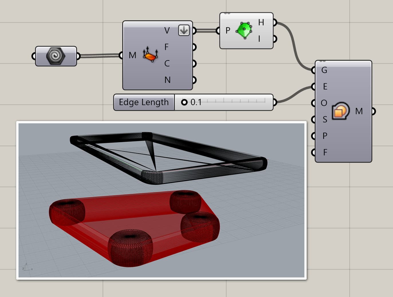

that’s the core behavior of the Minkowski sum, in GH terms it’s like if you translate B on “every possible superposition” over item A (no change of its orientation) and then make the final boolean solid union of all the states of all the Bs together
like here, imagine you translate B in every possible position over A:
you get this:
Thanks @inno I understand it on the iPhone example but on the other object the OP showed I don’t see what it does just yet?

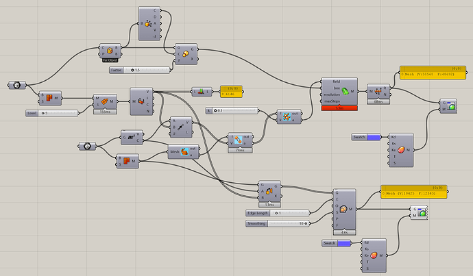

To be able to subtract the overall shape of a plug, something like a multi level convex hull would be needed. There was another topic not long ago about this but I don’t remember which it was.
Depending on the needed resolution, this could be done with Isopod or Shrinkwrap.
minkowski-isopod.gh (100.0 KB)
Shrinkwrap wins this game here:

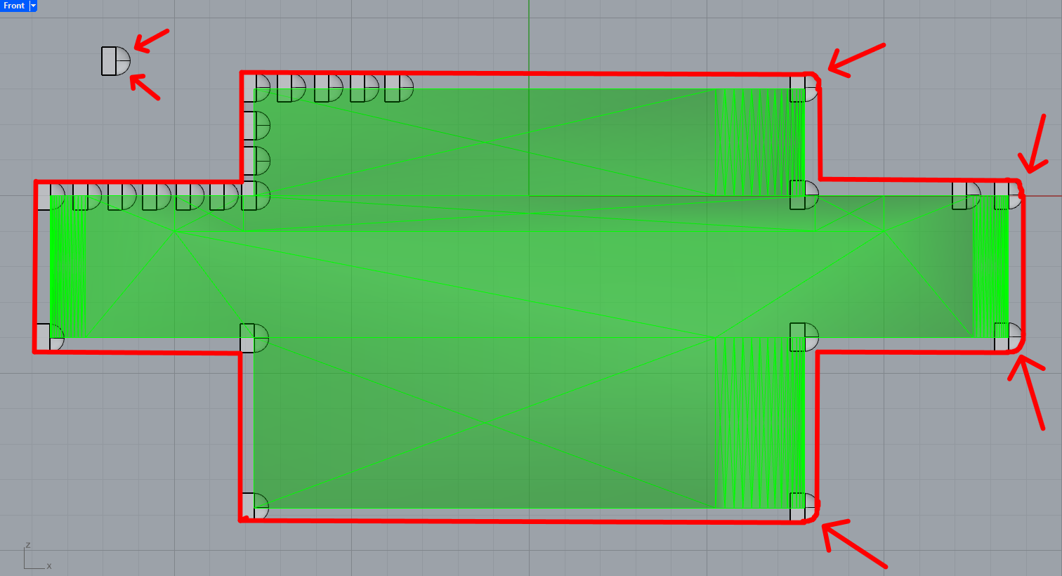

the result of the operation is similar to a solid offset, but the way you get to the final shape is through applying a solid part (B) over another solid part (A)
OP’s example is nice, but in order to really show the magic of this I think it would be even better to show a part B which does not have axial simmetry, or off center :+1:

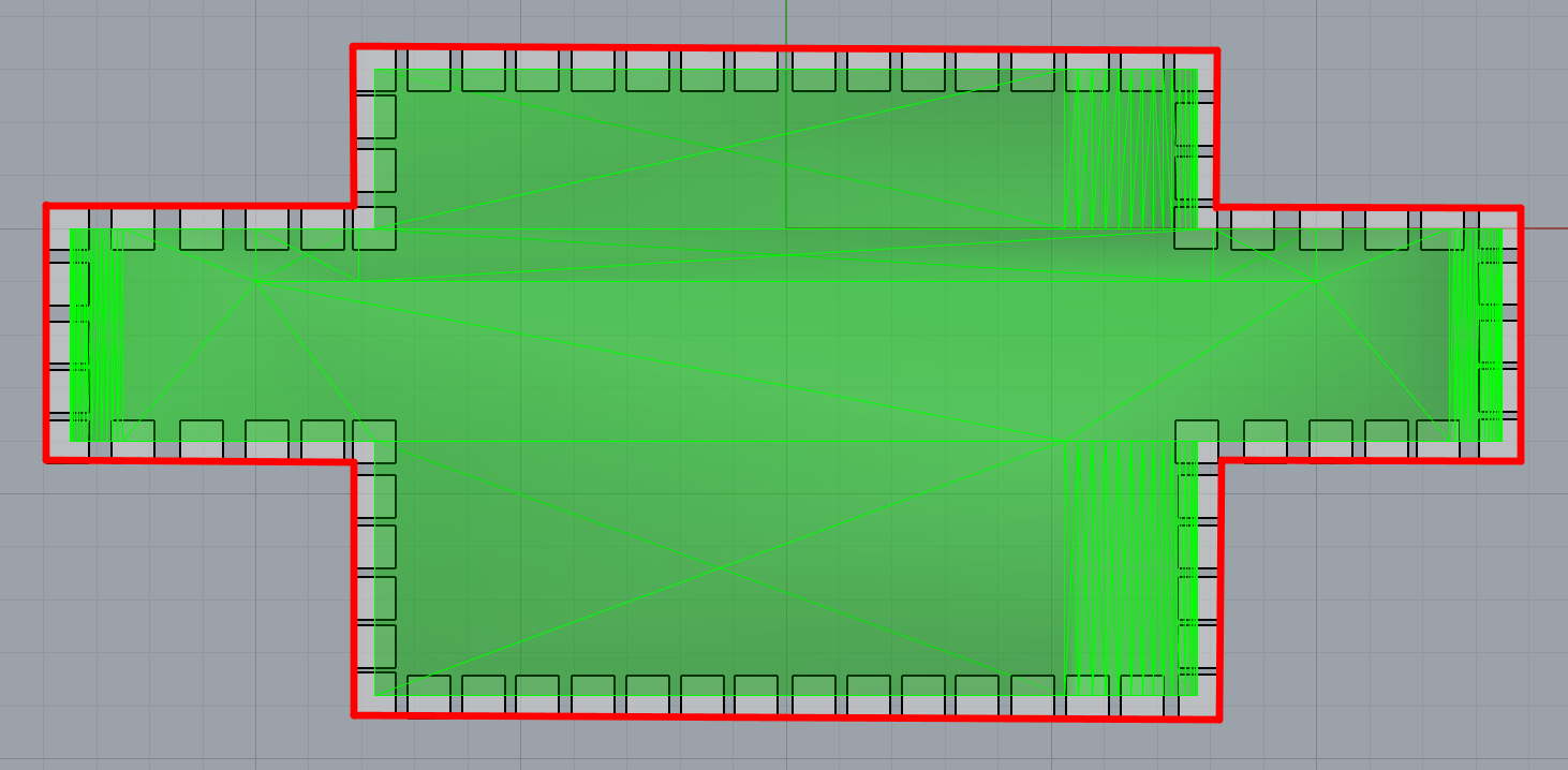

when you “slide” the tolerance cube over the surface of the plug (front view) you get a theoretical situation like this:
so it becomes something like:
pretty accurate sketch lol:
but instead of a cube centered on its perfect center you could use something like half a cube half a sphere, and you would get all the rightside of the original object with fillets and all the leftside of the object with sharp edge:
or even using a shape aligned off its center, in order to get more offset on one side and less offset on the other:

This works but I’m still wondering about the actual use? Your shape for the population is a simple cube so the result is very close if not identical to an offset…
