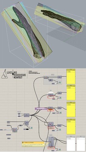

Hello everyone and thank you for all these interesting insights.
Below is my 2cents on this discussion.
💡 𝗧𝗵𝗲 𝗦𝗼𝗹𝘂𝘁𝗶𝗼𝗻 𝗜 𝗗𝗲𝘃𝗲𝗹𝗼𝗽𝗲𝗱
My implementation in the ATk MinBBox component uses a multi-strategy approach:
- Principal Component Analysis for initial orientation estimates
- Special case detection for geometric primitives (triangles, rectangles, trapezoids)
- Advanced angle-space optimisation algorithms
- Intelligent caching of previous calculations
The results have been validated: when compared to other available components, ATk MinBBox consistently offers an excellent balance between computation speed and minimum volume optimisation.
𝗜𝘀 𝗶𝘁 𝘁𝗵𝗲 𝗯𝗲𝘀𝘁 𝗽𝗼𝘀𝘀𝗶𝗯𝗹𝗲 𝘀𝗼𝗹𝘂𝘁𝗶𝗼𝗻 𝗲𝘃𝗲𝗿? 𝗠𝗮𝘆𝗯𝗲 𝗻𝗼𝘁 😅 Computational geometry is a field where perfection is elusive. But for my practical architectural needs, it represents the right compromise between theoretical optimisation and real-world usability.
This new component will be included in the upcoming ATk v1.3.3 release, and I will share more info about it.
