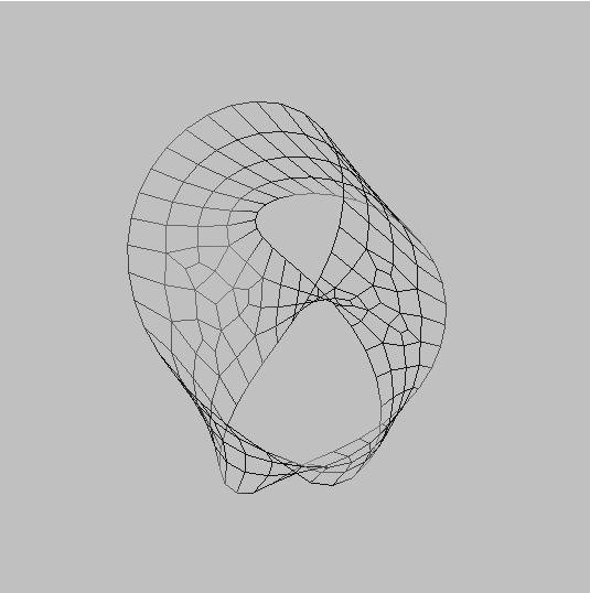

I started looking at how you do create a minimal surface from a trefoil knot wire and found this…
Soap Films On Knots
Anyone know how to create the initial surface that could then be Soap-Filmed in K2 to get a minimal surface?

Then you can create an initial mesh for a Seifert surface by choosing a projection and filling in the enclosed regions with mesh faces in a chequerboard pattern, including twists where the edges cross.

I tried a while ago some knot relaxation by repulsion, so you can input a knot as any old messy curve, as long as it has the right topology, and find the smooth energy minimising form of it:
knotrepulsion.gh (18.2 KB)
Seifert’s algorithm is quite simple. It should be possible to make something to automatically generate them in Grasshopper.

What’s the smoothing strategy? Is it possible with the K2 Goals or does it need more custom goals?
So far, using the custom repulsion goal from Daniel above and LineLength, I’ve designed Seifert’s underpants…
I’ve tried to give the naked edges more tension but as usual I seem to be missing something.
Constant Tension on the naked mesh edges plus the repulsion C# goal on the naked points transforms Seifert’s underpants…
Still not quite right in terms of mesh structure.
You need something for the internal edges too. Simplest would be Length goals with restlength of 0.
When I do that, this happens…
Smooth instead of Line seems to help but not if I subdivide the mesh…
Starting Mesh…
If I subdivide the initial mesh more…
this happens…
trefoil_mesh
trefoil_relax.gh (22.0 KB)
Here’s how I approached this. I was separating the generation of the curve from the mesh relaxation.
It is possible to do them both together, but then the forces keeping the knot curve smooth/repelled from itself need to be strong enough to resist the pulling in of the surface. I’d do this with Length goals and perhaps some bending too.
