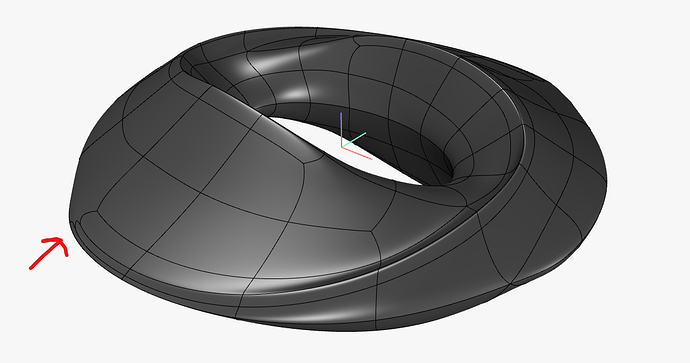

Although I had very little subd experience, I wanted to try it and this result turned out. There are some problematic spots on the edges and I didn’t know how to fix it. I’m sure Kyle will have some advice.

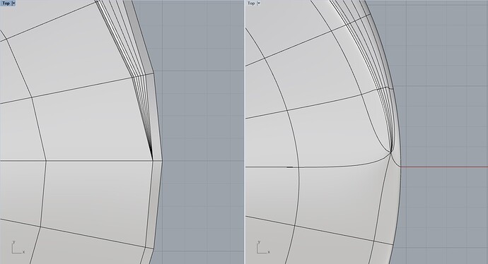

I noticed some issues and I would like to share them with you. Please see below

-Actually i don’t know how to solve the problem around these edges :sweat_smile: There are no problems in flat mode.
-The transition between the surfaces in the middle is smooth. (first picture I shared, the bottom part was darker because of the reflect command.) But I haven’t found a way to smooth the outer edges (yet).
(As I said, I have no experience in subd. for this reason, I may have skipped some simple points. This is just a work that I have done to improve myself.)

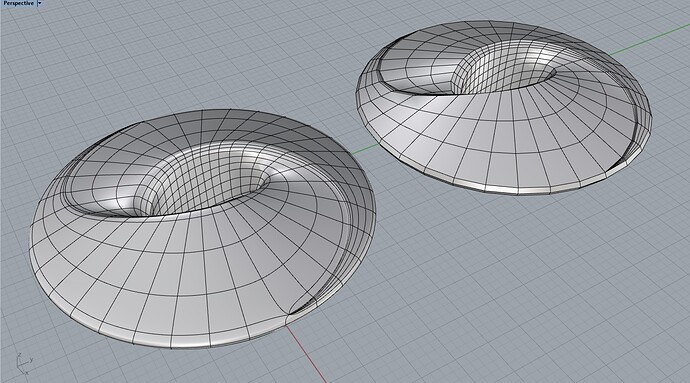

I see what you mean. I am going to post a cross section of my model below, hopefully it will help you for your final model. I am going to also create a triple twist soon and post it here. They get easy once you understand how to build it. :slight_smile: Please take a look
Cheers
can you post your file?
Here is the Triple Twist, Binary Twist and Single Twist

Hi Kyle,
This is the second time I ever worked with Subd and don’t have much experience with it. I should say that Subd is a great tool for Industrial designers (like myself) when designing new forms however, achieving what you already have design with Subd is tricky. Below is my Subd attempt. I tried to snapshot every detail I thought is important.
