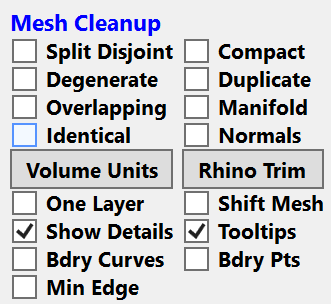

To use the script:
0. Display only 1 mesh in the Top View
  1. Run the script. This will move the mesh to the Start layer and copy it to the Normal layer. The mesh on the Start layer is never changed. It is your original mesh.
  2. Select an Operation
  3. Enter a closed boundary curve (or Select or Reuse an existing curve)
  4. Select options under Show Options
    Options
  5. Press button in lower-left corner of GUI with name of operation (Split Mesh for last example).
  6. Use Layers panel to control display of results.
This script works on all my meshes including many that Rhino’s built in Mesh Tools cannot split or trim correctly. It does not work on all meshes as there seems to be no limit to how many special cases there are that need special handling.
