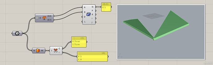

Clash detects a clash, collision in Grasshopper also works fine.

I was able to reproduce this with the MeshBooleanIntersection command after extracting the render meshes. I logged this as RH-65084 for @piac.
