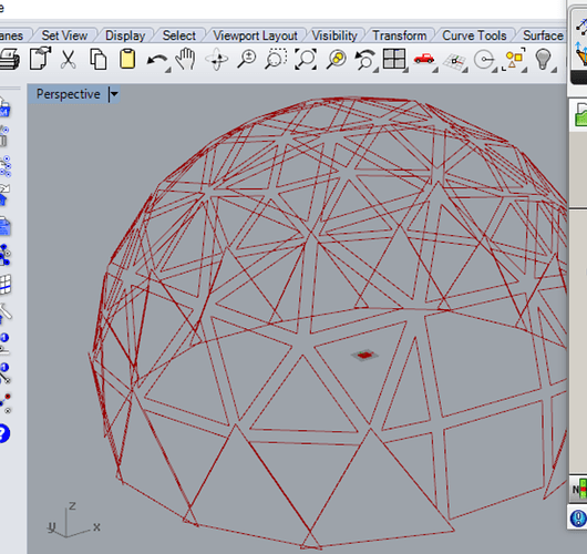

Can anyone explain why the face boundary offsets on this mesh are inside on most of the mesh faces but outside on the triangular mesh faces with naked edges?
I’ve tried unifying mesh normals and face windings and tried K2’s Mesh Direction but it gave an invalid mesh.
Are there any tried and tested ways of ensuring a mesh has all it’s face vertices listed in the same direction around the face?
This is a bad mesh in that it has 2 quad faces and the rest are triangular.

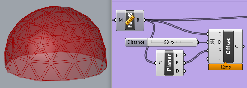

Your mesh is fine.
There is no “inside” or “outside” of a 3d curve, even if planar.
Offset function can use an optional plane to determine the direction of the offset. Use Planar to get a plane for each triangle and use that.
Or… you can use Offset Loose and bypass this problem.

All faces in your mesh are consistent, all counter-clockwise as expected.

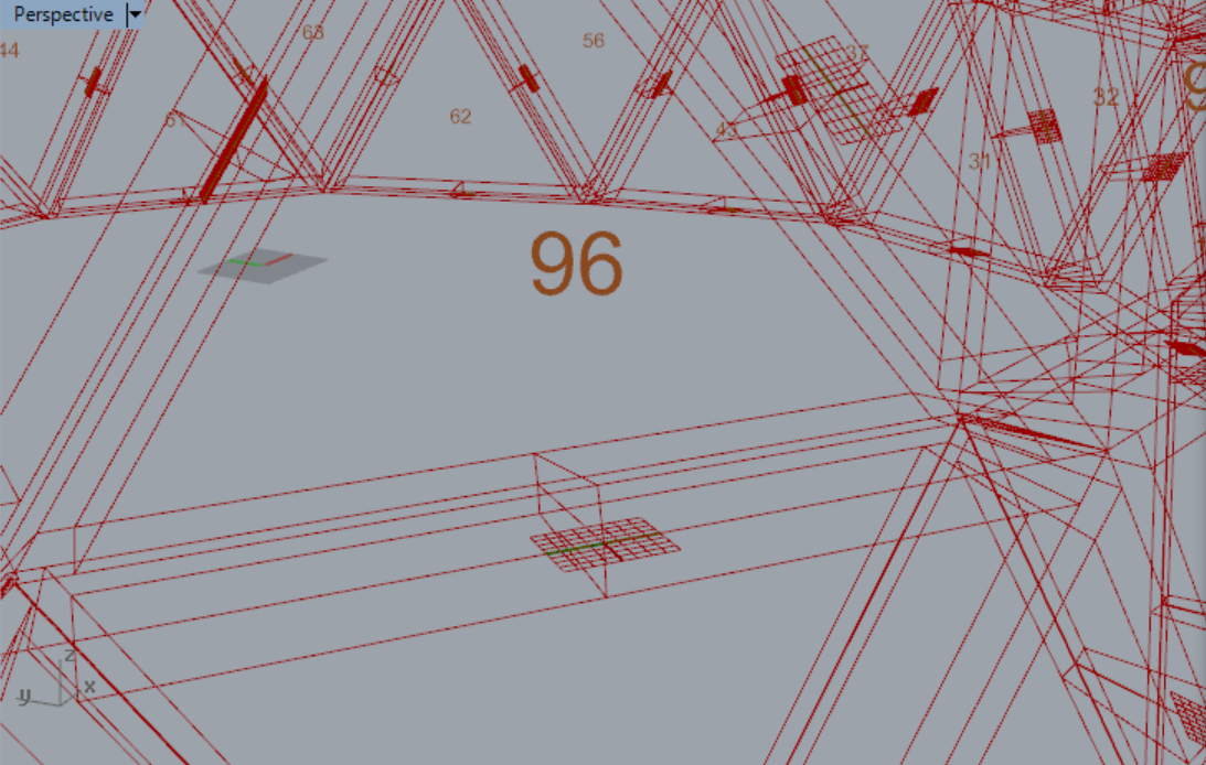

The file is getting a bit wild! its the bit circled in red that I am trying to improve.
I know now that there is a problem with this approach because the mesh needs to be conical to work with straight (planar) struts.
I am trying to model what would happen if I made the mesh from rectangular section timber frame by making each mesh face and then adding the face angles on the timber edges.
And then look at whether its possible to modify the corners of the triangle so they fit together.
Maybe there is a better dome mesh than a geodesic dome that is suited to this manufacturing technique?
