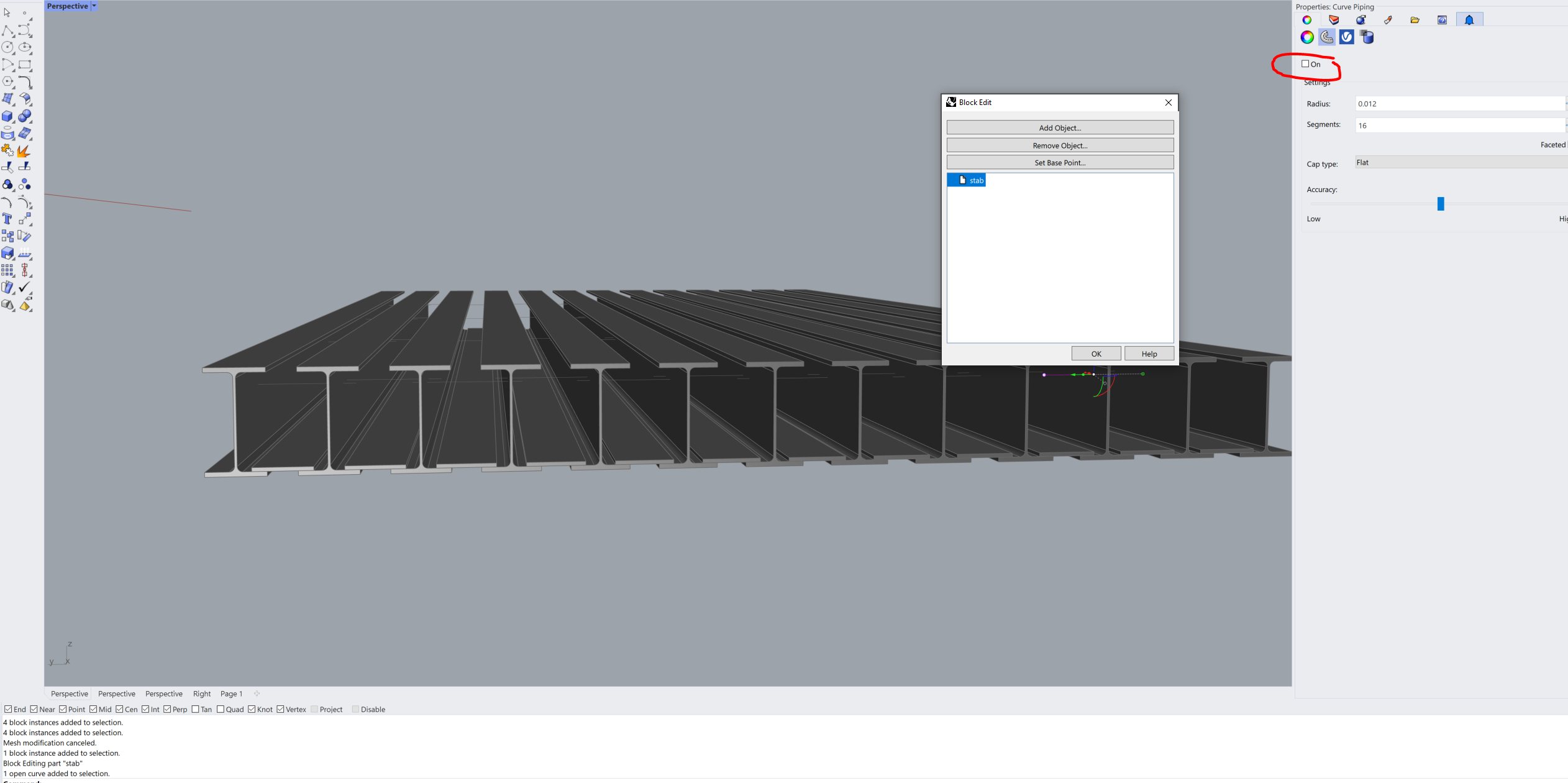

I dont know what i do that my mesh modification is randomly canceled when manipulating with blocks.
I dont do anything intentionally to turn off the pipe modification. It keeps happening.

i already have block with curve piping enabled but when i manipulate the block, e.g. copying with gumball, sometimes curve piping inside block is disabled which is also noted in command line. i cant tell what triggers it specifically. sometimes esc button. sometimes opening block instance and moving control points. sometimes just copying whole block instance as i mentioned earlier.

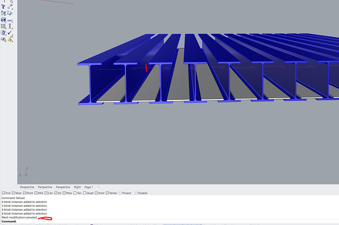

It happened again. I was just working in layouts not manipulating with the model at all and suddenly i realized some of the blocks are missing mesh modifications…
You can see its recorded in command but i possibly could not trigger it manually because those modifications are defined inside blocks and i did not even open one for editation…

It is pressing escape that cancels and disables Curve Piping. It happens very easily in Rhino because escape is used for other purposes too. And it also happens when other application is active. I’ve logged an issue for improving this: https://mcneel.myjetbrains.com/youtrack/issue/RH-72550/Escape-turns-off-mesh-modifiers-too-easily
