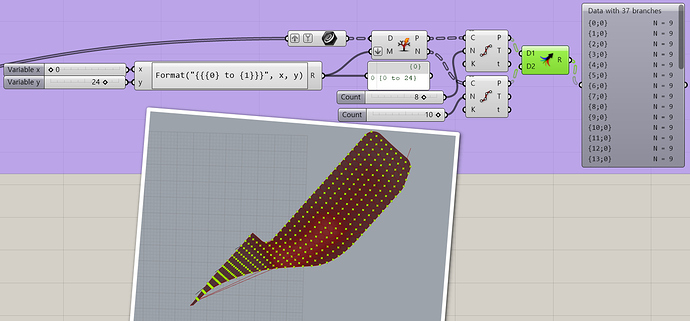

I have a list with 37 curves which I am splitting because I want to divide some curves in 8 segments and some in 10 segments.
After dividing the curves, I would like to merge the 2 lists again in order to link the points on the curves.
However, when I merge, or add the lists, I only end up with 25 curves.
Is there a way to merge the lists to have the initial 37 curves back?
skylight 1.3dm (1.8 MB)
skylight 1.gh (67.9 KB)
did you try with entwine component?
Try to use Split Tree.
skylight 1_re.gh (38.8 KB)
Super :slight_smile:
thank you so much! I would’ve never been able to come up with that!
