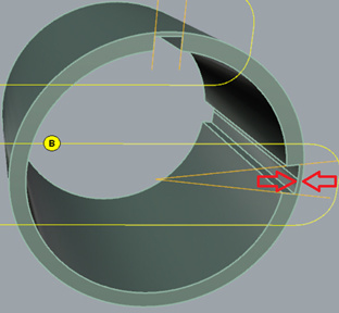

Q: If I didn’t have to care about standard components or manufacturing cost, which solution of A and B below would perform better in transferring torque, the parallel or the tapered wedge(term?) as illustrated below? (and how would force vectors illustrate the relative difference, if significant) :
Edit:
Q2: For example, should I be concerned about the stress near the “inner corners” on the axle groove being worse for B than for A, or insignificant?
Q3. Also, if the outer ring would have only little bigger diameter than the top of the “wedge”(term?), say 20% of the height of the wedge, would alternative B be significantly more beneficial in that the force vector at the contact point would start more aligned (tangent) than A?

If you have any concerns about the torque capacity of the key you should be using a tapered joint (perhaps with a key) or a spline joint.
I doubt the difference in stress capacity, etc between your two key proposals is noticeable, and the tapered outer slot for the “wedge” key would be much more difficult to manufacture than the parallel sided slot.

What I absolutely want to avoid is having the key tend to twist out of the inner groove, and the outer ring being bent/pressed outward by the key (into an oval shape) due to the torque forces.
I should have drawn the typical ring thickness to be around 10% of the axle diameter (the ring was drawn a bit too thick here). Updated picture:

Providing the distance “d” is the same in all instances, all designs are going to transfer torque the same way. The distance “d” will dictate the shearing plane that will size up the key’s width and length, to withstand a torque X at a safety factor of whatever you can afford. From my own experience here is what I think of all options:
Design A
It is widely used across industry because of ease of manufacturing. You can cut the shaft (axle) with a cylindrical end mill and the key channel in the outer ring with a rectangular broach. The keys themselves are cut to size from standard stock bars.
The problem with this design is in case you are using loose tolerances (needed for ease of assembly), it will lead to a small play of the outer ring on the axle, which in the long run will end up shearing up your key. The key starts to slide in two different directions exactly at the shear plane. This design had given me headaches many times when trying to replace the key.
Design B
Making the right size key slot becomes an art. If for instance on the outer ring you use a broach to that profile and you don’t hit the sweet spot as marked “?” in my picture, you either have a play when you go too deep, or you cannot install the key if you go to shallow. The shaft is not that critical as you can always use a tapered end mill and cut a deeper channel.
Design C
If this was my project I would use this design. This way the cutting of the outer ring key channel does not need to be that precise anymore. To avoid the key moving at all, I would hold it to the shaft with a screw.
Q2
In regards to the key channel in the axle, I believe the tapered design is slightly better than the straight design. Why? Because the tapered key channel side walls are wider than that of the straight channel, and also the distribution of stresses to that side surface would be rather perpendicular to it (slightly better condition than on the straight wall).
Q3
I don’t understand it fully, but I think if this is a scaled model, then this outer ring channel is not meant to last. Your keys, no matter the design, may end up ripping thru your ring.
If you follow my picture, the meat on top of the key in the ring is thicker that the depth of the channel in the same ring and that way I know if anything goes it will be the key and not the ring.

Because of various constraints which I evaluated only after my first post, I came to the conclusion that I can only possibly use alternative A or C. With this guidance I will go for alternative C (I was just about to start doing the Grasshopper definitions, so your reply came very handy in :slight_smile: ).

I think I got Q3 the first time around. I don’t know much from you pictures as to how this is assembled, but if this ring is not the inside bushing of another gear or pulley, then I would not make it that thin. First picture shows (again, as I would do it) a scaled model of the key, taking into account the shaft if 150mm and the thickness of the ring is 15 mm. Screw can be M6 or M5.
Notice the fillet in the corner of the key-way in the ring. I recommend it in your case very much.
Second picture illustrates the broaching of key channel.
