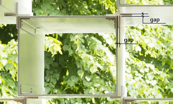

for your second question, this page offers very nice and insightful picture with awesome details: Serpentine Pavilion 2016 by BIG such as:
where you can notice that L shapes in the inside of each box are as long as the box extrusion (a few mm less)
while outside connection elements shaped like a + are as long as the overlapping edges of neighbor boxes (same few mm less)
another important axpect is that the initial grid size we have set (400x500) would produce a result where boxes have common edges:
while you want the box size to be respected despite having a gap in-between which is equal to the thickness of the + connection elements:
the easiest way to do that is to create a new parameter that sets the thickness of the + connection element, and sum it up to the size of the cells:
this means that each cell will need to be offset inwards by half connection element thickness before being extruded, or if you want to see that from a less geometrical and more parametrical point of view, it means that the grid of planes on which construction planes are created should take into account that thickness, while the rectangles size should not (by doing this we avoid 875 -useless- offset operations using just two spaghetti wires :slight_smile: ):
