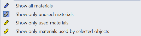

  1. Materials deletion of unused Materials is kind of painful.
Ideal workflow: open Materials window, right-click, select “Show Only Unused”, CTRL-A, DELETE.
That doesn’t work, however, because when you CTRL-A, or shift-click, you’re actually selecting all of the used Materials, too; they’re just not being shown. If you use DELETE and pick “yes”, you’ve just zapped all of your Materials. Not ideal, lol!
So, instead, you need to “select unused”, then manually left-click on each one, hit DELETE, hit Y for “yes, I want to delete this”. It’s not a big deal for 1-2 Materials, but I’m having this issue with 20+ in multiple files, lol.

Have you tried the command _Purge?
Nope. What does that do?
Tried it. That did the trick! Thank you, I wouldn’t have ever figured that out!
Hi @Gregory_Wolfe ,
Using the options menu in the Materials panel, I was unable to repeat the behavior you described…
The used materials are not deleted for me here in Rhino 8. Check if you might need to update your service release from Rhino - Downloads and if you still have this issue, email tech@mcneel.com with the results of your SystemInfo command and a small sample file please so we can try and reproduce the bug for our developers.
